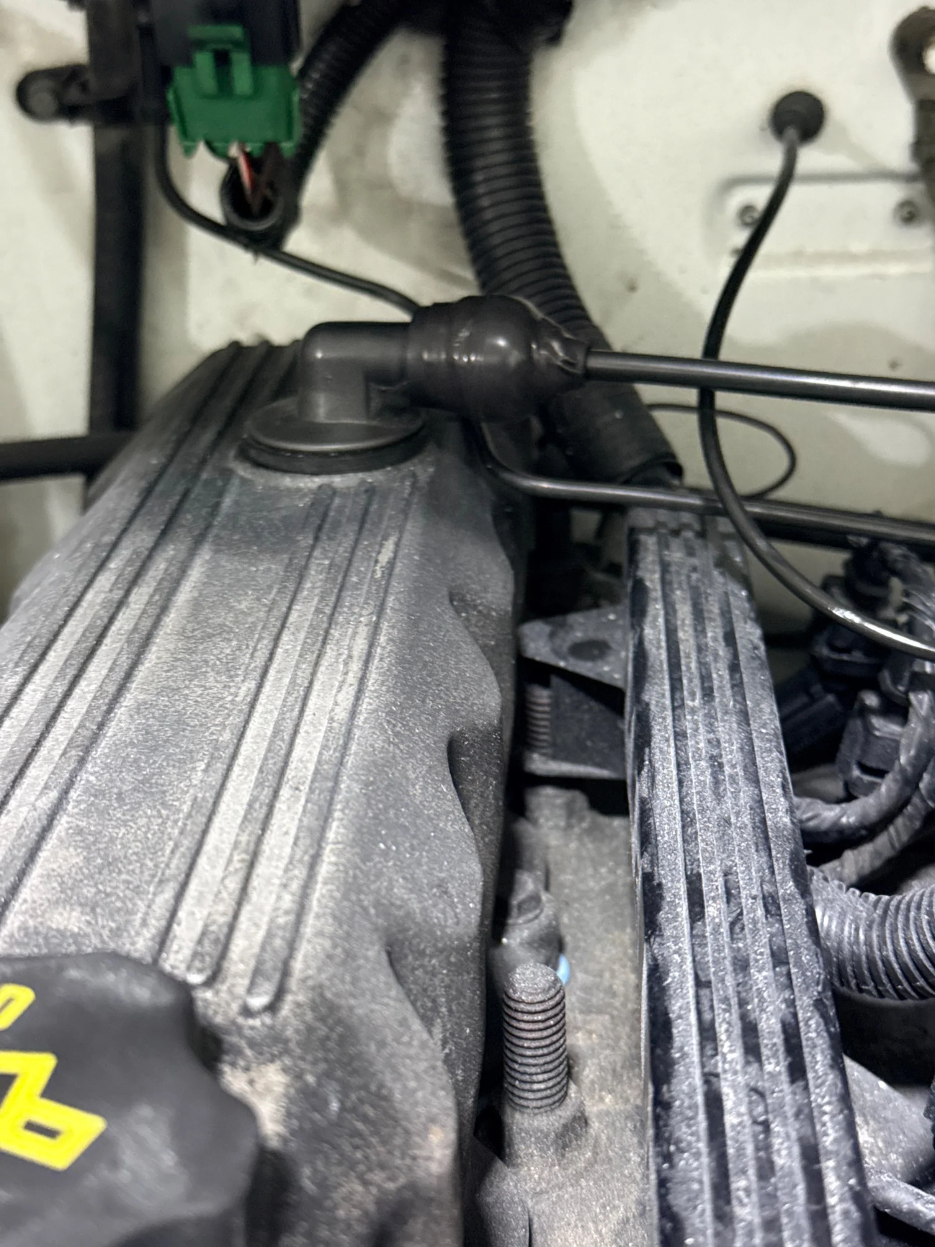

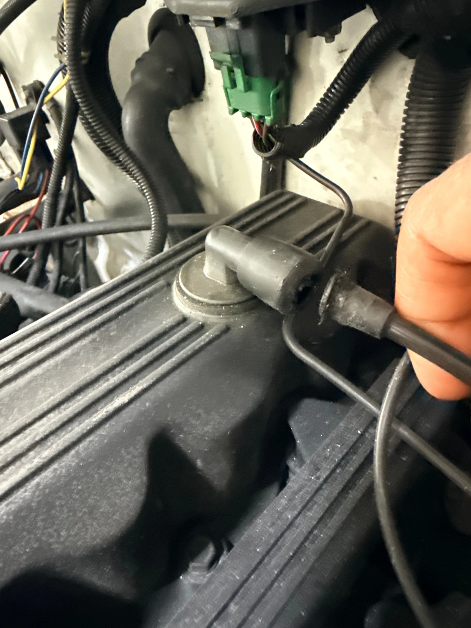

While I was in there I found something that probably mattered. The crankcase vent tube going into the elbow had clearly been glued at some point by the previous owner. When I moved it out of the way it split right along that old repair. I wrapped it with high temp silicone stretch and seal tape just to get it sealed since I don’t have the replacement yet.
After sealing that, the engine smoothed out even more. The airy or “puffy” sound I originally described is basically gone. The slight dipping I used to notice is still technically there if I really focus on it, but it’s minimal now and doesn’t affect how it drives. Throttle response is clean and it just feels consistent.
Where I landed on all of this is it was probably a combination of things. Sitting for a long time, airflow and fueling not being quite right, and that vent line not being sealed. Resetting everything and letting the ECU relearn with a sealed system seems to have brought it back.
I’ll replace that vent line properly once I track down the right piece, but for now it’s running the best it has since I got it. Attached is a pic of the torn vent tube and the temporary repair.
