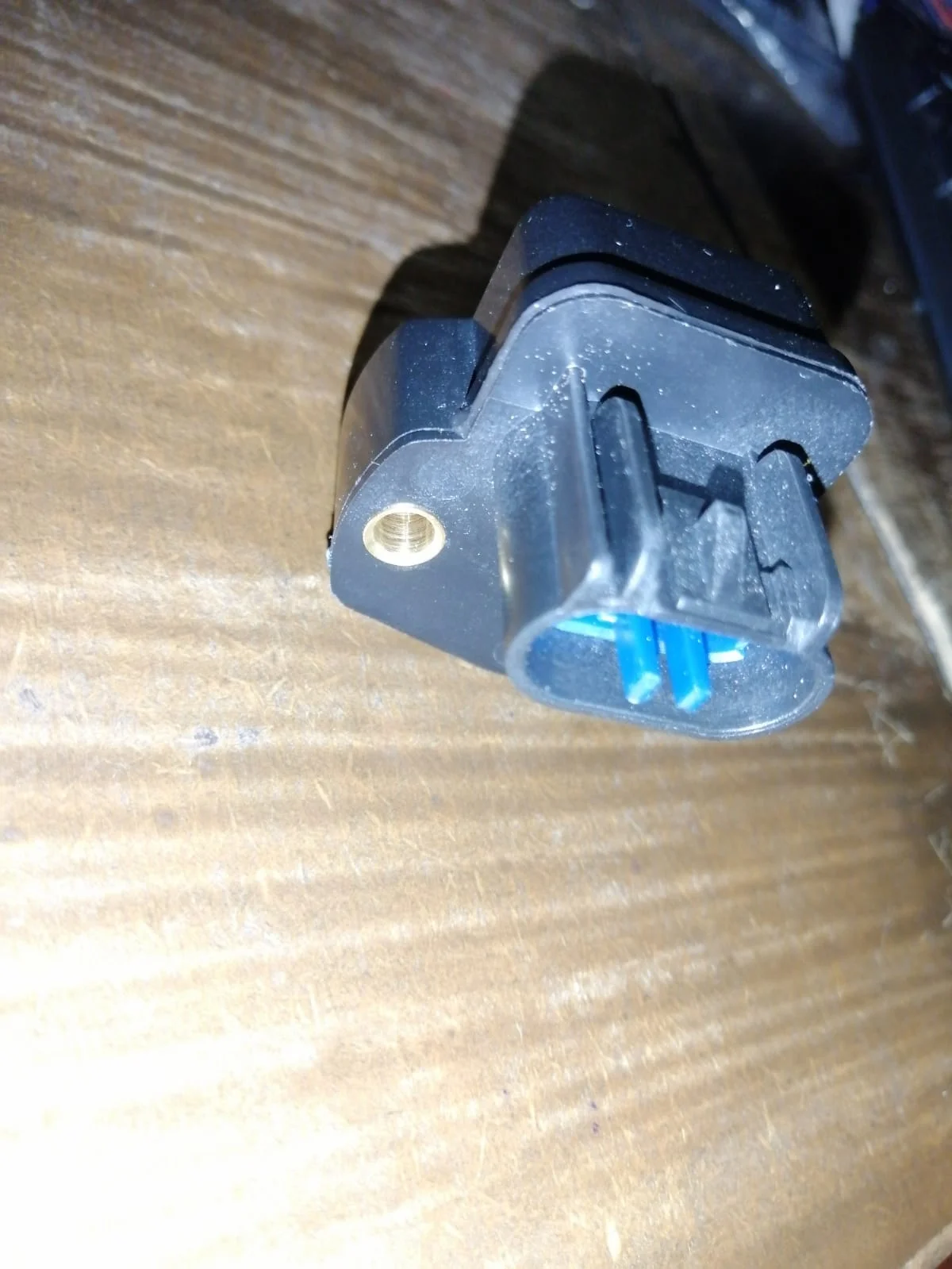

Hi dudes. I would your help to solve my TPS trouble in my jeep. I have an YJ Jeep but with 4.0 TJ 2004 engine with his electronic, so this is an OBD2. I have the code P0121
First I buyed 2 MOPAR OEM TPS on Amazon, but I can´t read any voltaje variant when move the thorttle.
I have the next information:
Pin 1 connector = Sensor Ground
Pin 2 connector = Throttle Position Sensor Signal
Pin 3 connector = 5V Supply.
I decided cut the conector to try the lines with single conector by terminals on TPS, to guarented avoid any problem with the conector.
So, I Find pin 1 with ground corretly, pin 3 with 5 volts, but when I tested the pin 2 without to pcm connection, I can´t read any any voltaje variant when move the thorttle.
I have some questions:
1. If I provide ground and 5 voltaje supply on the pin (1,3), I don´t need conection to PCM to read the voltaje variant, right? The PCM just receive the voltaje?
2. I would have such bad luck, to receive 2 MOPAR TPS that do not vary their voltage?
3. If I connect the PCM on pin 2, this also not work to, and I can´t read any voltaje variant.
4. Any have any idea, to solve my problem?
5. Any know how test TPS ressitence? It´s possible test a TPS without power supply just testing his ressitence between pins?
