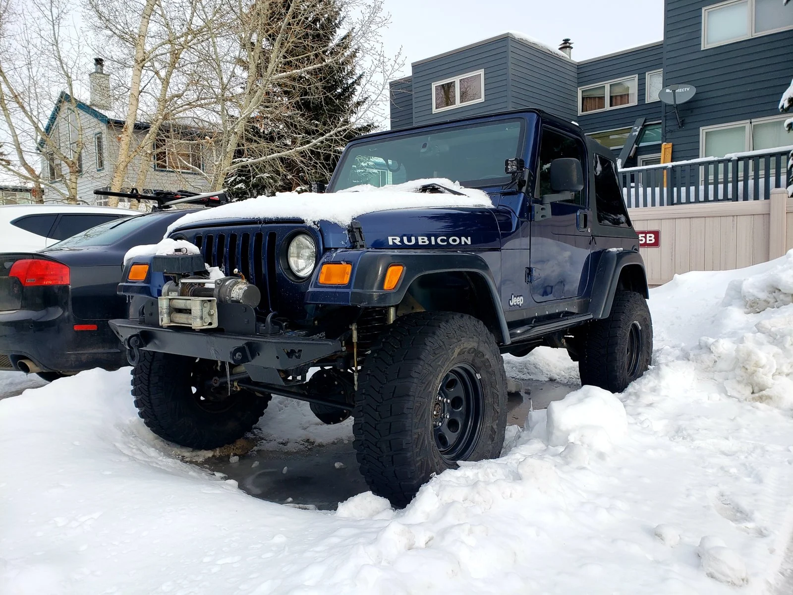

In this pic I have 4 inch Currie and savvy with 33x12.50x15
