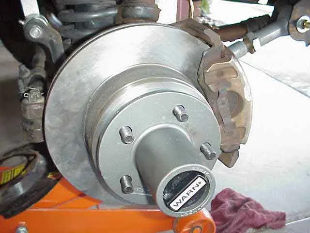

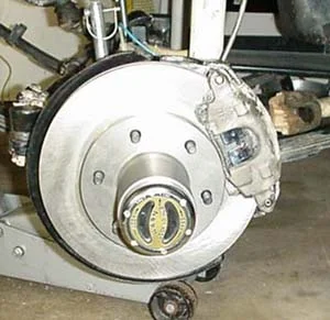

Manual hubs would have a big knob to lock/unlock the hubs right on the hub where it passes through the front wheels.
Like either of these...
Also check that the front driveshaft is there.
Unlocked manual hubs or a missing front driveshaft will cause grinding when shiftjng into 4Hi.
