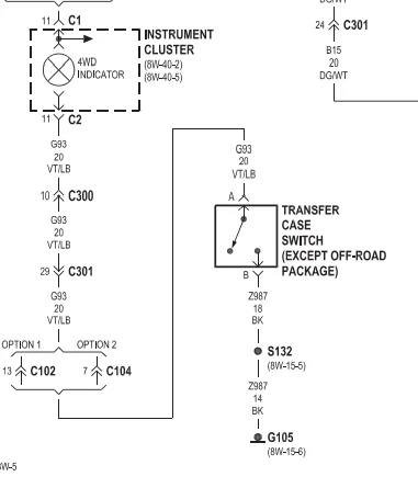

You have a short to ground on the black/red wire between the tcase switch and cluster.

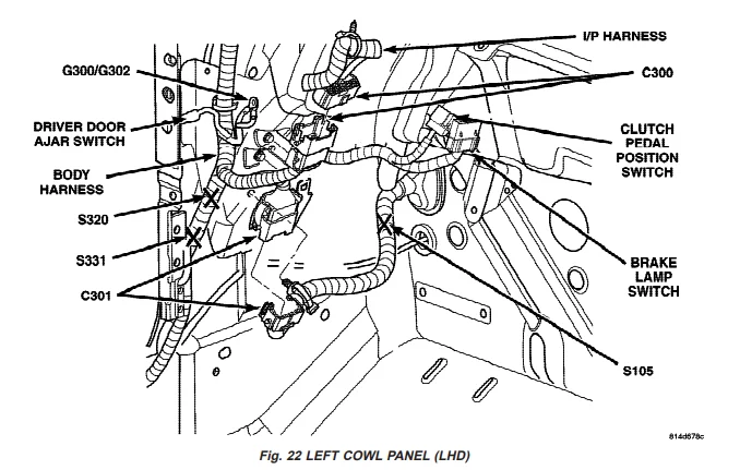

For an '06, from the instrument cluster, it runs through connectors C300 and C301 in the driver side kick panel before going to the switch. You'll want to go to this thread and download the right FSM for your year to get the right wire colors, connector locations and pinouts, etc.
I agree with @Lou, and the differences in our diagrams regarding connector designations and wire color is evidence of Jeep changing things year to year.
The diagram I posted is for 1998 because his profile says he has a 1998.
