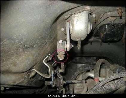

The transfer case shifter mechanism can get out of adjustment if the shift rod that is supposed to be held by a lock bolt slips. That bolt has a 1/2" bolt head, the mechanism can be easily adjusted but you have to get under the Jeep.
Here is the mechanism with the bolt circled in red, you can see the rod that the bolt is supposed to hold in adjustment. You can sometimes see the original mark on the rod made by the bolt to help figure out where the factory originally adjusted it.
