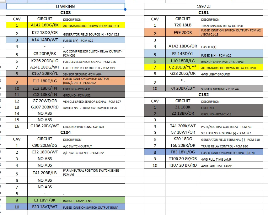

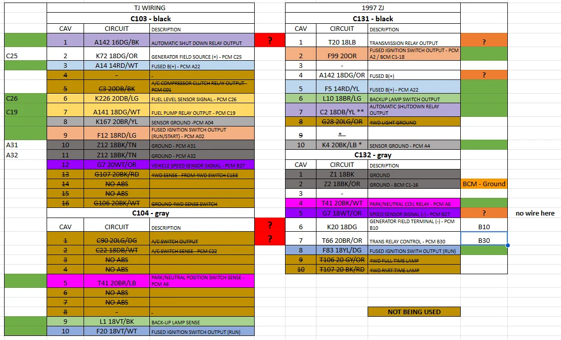

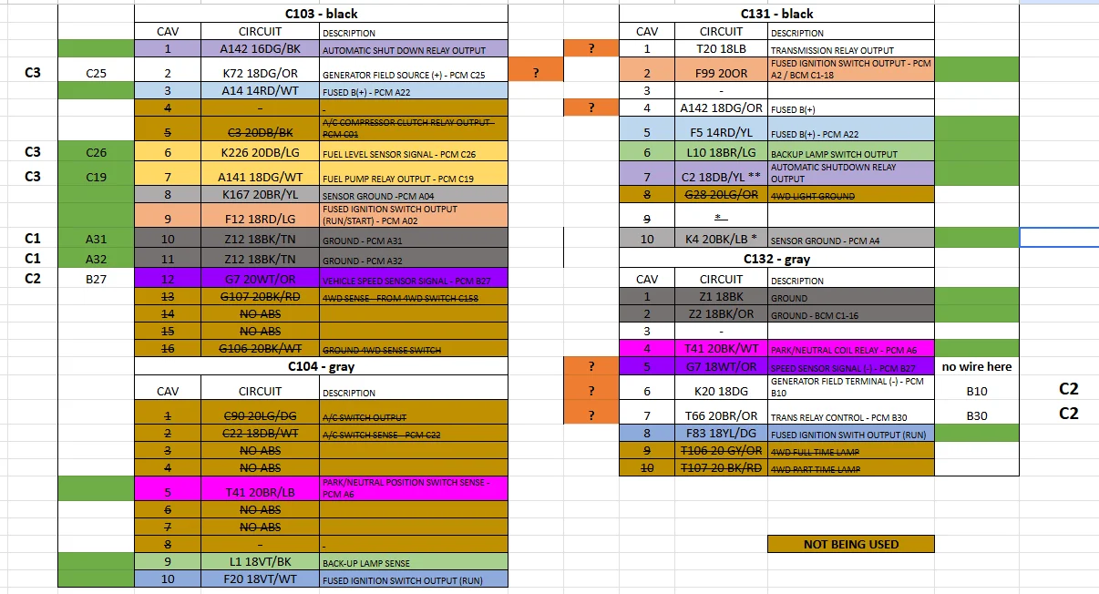

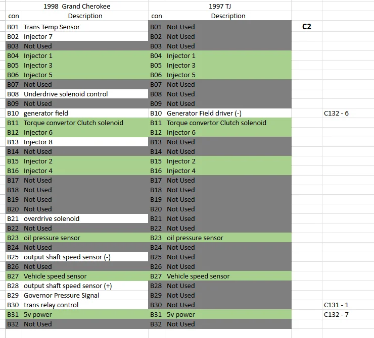

My other issue is now that it’s shifting kind of right I have a misfire issue that seems to be on cylinders six and eight started doing the research on it and the ram computer apparently has six and eight tagged together in the ECU but the CJ wiring harness does not so I think I gotta make one more jumper wire.
Overall, for a wiring harness that I built over the course of 2 1/2 days and got it up and running, and the only thing I was dealing with was a speedo issue, which turned out to be a bad VSS I’m pretty pleased with it. it’d be nice though I actually know how this thing runs and does between the slippery transmission and the erratic shifts and the misfire. I still haven’t got to view 100% performance. I’m also burning a little bit rich, but I think that’s due to the lack of O2’s. I’ve gotta redo the exhaust. It’s too short and no place to put them..
