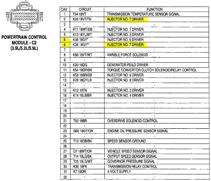

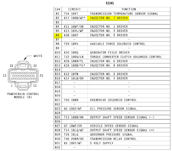

In the following I'm wired to the ZJ plug but the RAM plug has same injector 2 spots.
WHY?
Does it mater?
WHY?
Does it mater?
Which one applies to your wiring? If it's running and all your injectors are firing I wouldn't worry about it.

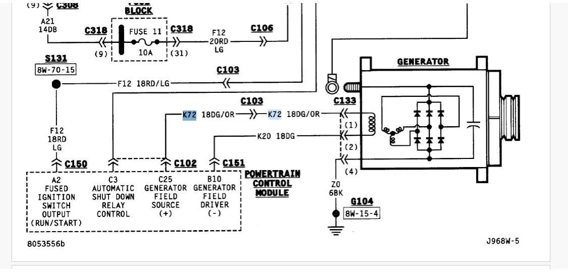

And sorry haven't had time to look at the alternator wiring. I do know that on a TJ compared to a RAM it's different but don't know about a GC.
Your PCM is what controls the voltage from the alternator.
My setup is
TJ firewall harness and PDC, RAM ECU & ZJ Motor/Trans Harness.

My setup is
Well then I wouldn't worry about what a RAM FSM is showing.

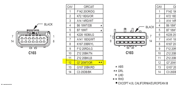

on my C103 plug I don't have the wire..
It goes right past the plug to the PCD
On engine side I have that wire to ECU and down to the VSS
Do I need to split into it ??
So no I don't think you have to split it. But you've got to have the input VSS from the t-case and it was a sperate harness as I remember.
