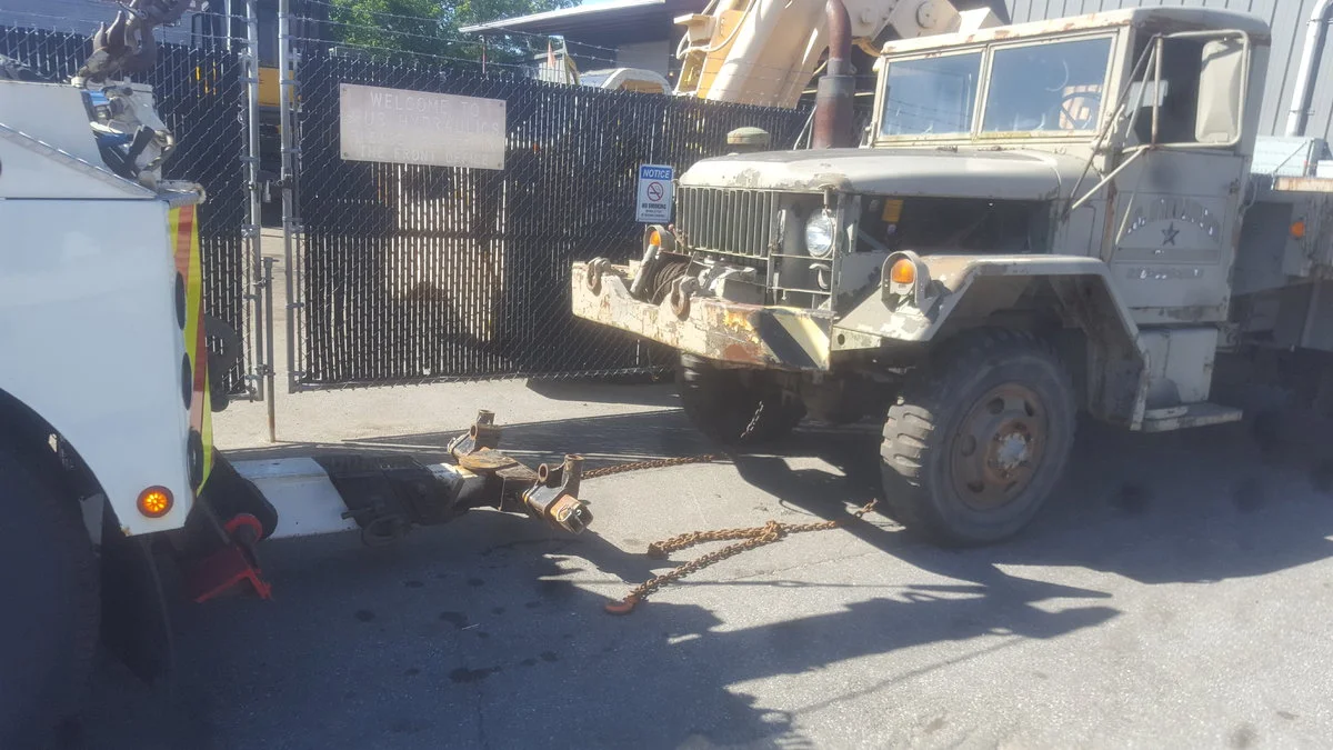

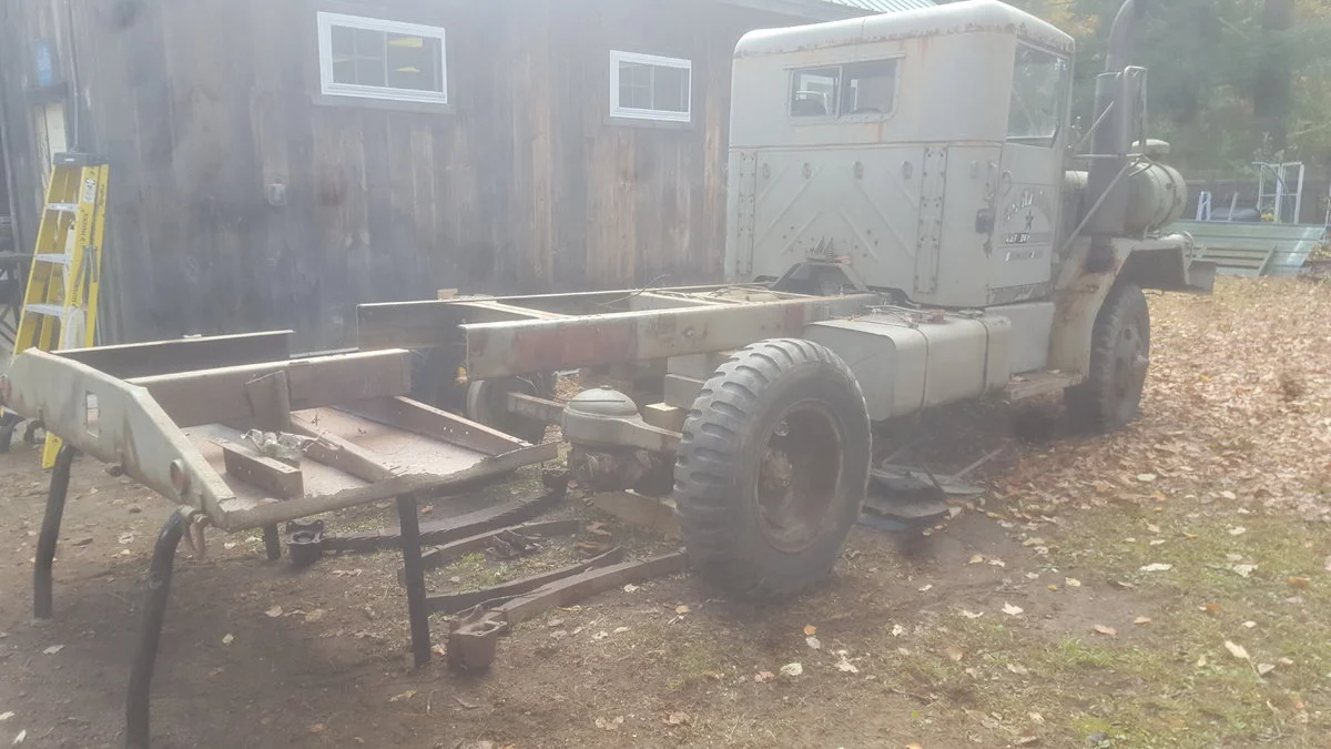

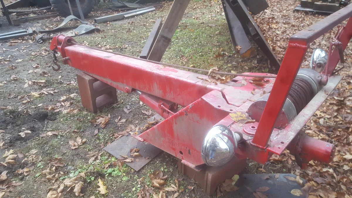

Building an off road wrecker... has front pto winch, rear 8k hydraulic winch, 10k boom winch/ telescopic boom. Will be outfitted with a 5k gen, hydraulic ports for hydraulic rescue tools ( I have cutters, spreaders, combo tool, jacks, and impact gun). Will also carry oxy/ acedalyn torch. Trying to figure out welding issue... I can braze, but that sucks to do in my opinion. I also have regular tools, tow bar w/ axle clamps, chains/ hooks etc, chain saw, bumper mounted large vise...
Anyone have any other thoughts from an issue they had out on the "trail"? It will look simalar to the last pic when done...
