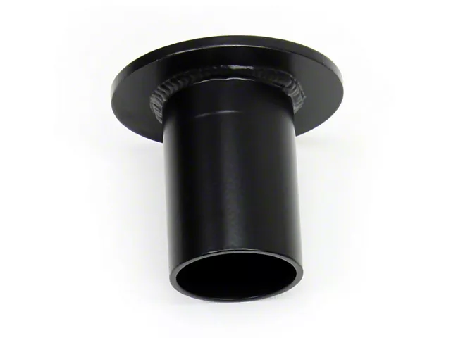

The issue I have is that the mount that the jounce cup and bumper mount to are gone. after measuring the factory mount it appears to be 5-6 inches. The mount with the jounce cup are about 6 inch total. I can find jounce cups and bumpers all day but no mention of replacing the actual mount that the cup attaches to.
I read from back in 2018 that a guy had the same question and problem. I have had a challenge loading pictures from my phone to the forum so I don't have them available. The recommendation for the poster at the time was to uy a whole new or used shock / spring entire frame support and all that comes with it. That would make sense if I had any rot in the surrounding area, but I don't. The only thing rotted is the mount that the cup fastens to.
I've attached a picture of, I think a quadratek part that appears to be exactly what I'm looking for. I notice that I find different info about it's use, meaning their website mentions "for a 4 inch lift" or some such. All I know is that it wasn't stock. I found the same product listed on other sites and when you apply your specific Jeep, it will tell you "this fits!" or "this does NOT fit!". Well, with my stock info, it says it fits my TJ.
Does anyone have info on replacing this part only since the 2018 post was made? I'm installing new shocks, removing all the springs and control arms to apply 3 coats of Mastercoat silver to the springs and sway bar linkage rods, so I hope to have room to work without having things in the way.
I'm not a welder or fabricator, but I do have a nice Lincoln mig welder that I fully intend on using and learning to make good welds with. I'm not BRAND NEW to it I've just putzed with it in the past. I have confidence that I can do it if this is the part. Once I actually remove the front springs I'm sure I'll have a much better view of the situation. I didn't know it this part as stock on the Jeep is welded or pressed or what? I know it's easier said than done, but as clean and solid as everything but the mount is , it would only make sense to remove the part and replace it. Grinding may prove to be tough in the tight space so it there's anyone one with experience with this specific situation I'm open to suggestions.
