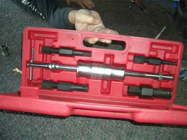

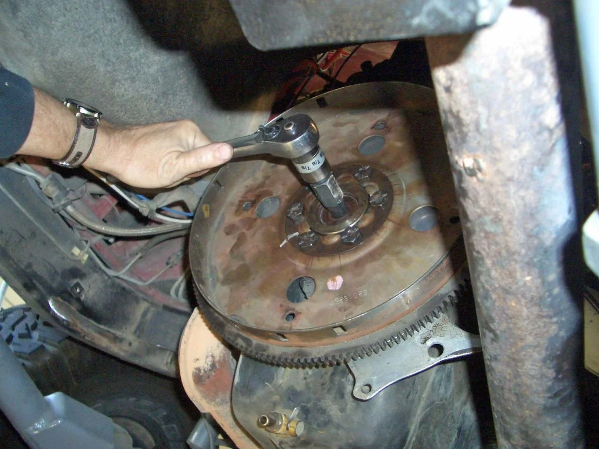

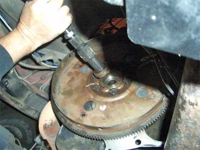

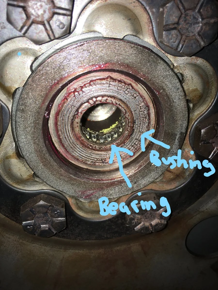

Wow that blind puller tool is a life saver!! That was extremely easy. Perhaps not all are like that, but i'm sure thankful this one was. Actual time to remove the bearing and bushing once the tools were installed was under 1 minute. Thanks for the suggestion Jerry!!
