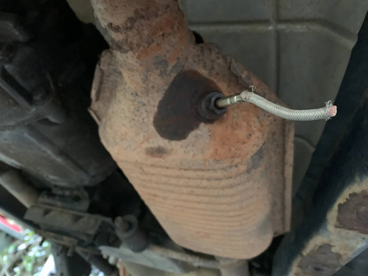

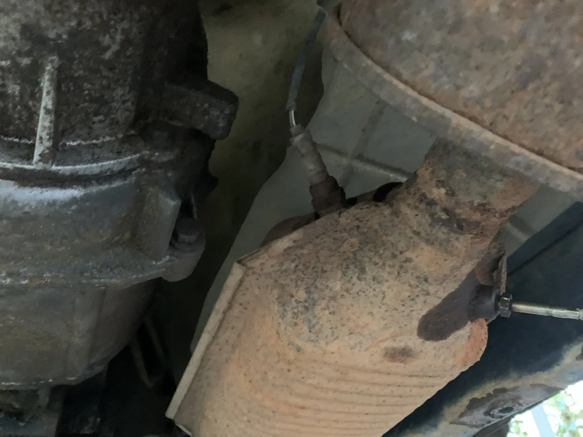

Hey @Jerry Bransford, while we’ve got you talking about ‘97 4.0 O2 sensors, what do you make of this?
Pulled my belly skid off to do some maintenance and while looking around saw an O2 sensor near the top of the cat (pointing at TC) and this second one highlighted by penetrating fluid I sprayed before dropping the skid. Wires have been cut, and I can only assume have been that way for a long time. The Jeep runs fine, no check engine lights, haven’t checked codes lately, but is usually fine. We don’t have smog testing here.
This is the main cat right? If not both O2 sensors, what else would I be looking at?
I dunno, everything looks upside down there, I had to turn my phone upside down. 🤔😁 Actually I've never seen two sensors screwed into the main catalytic so your second sensor is a mystery. It doesn't look like an O2 sensor to me either, a temperature sensor is a good guess. . Does NZ have its own set of extra strict smog laws like I do here in California?
I've read through the FSM and parts guide and couldn't find anything either.
We have no Smog testing at all, so won't be related to that...
How interesting!
I glossed over it yesterday as I was focussed on other things. I'll check it out tonight, I might be able to tell if the weld in bung looks factory or not. Export models may have used a different cat that had the sensor in there for another application, who knows. I'll let you know my findings
