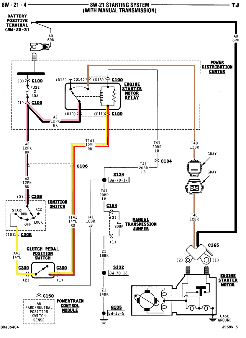

If you do have a 4Cyl 5 speed use this to trace down power from the Ignition to the starter:
