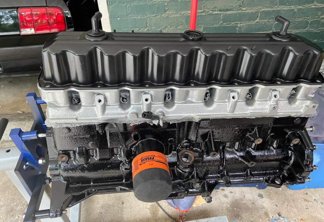

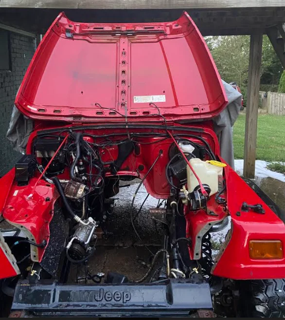

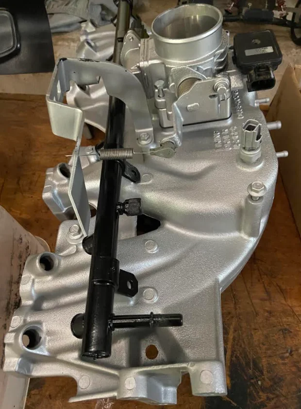

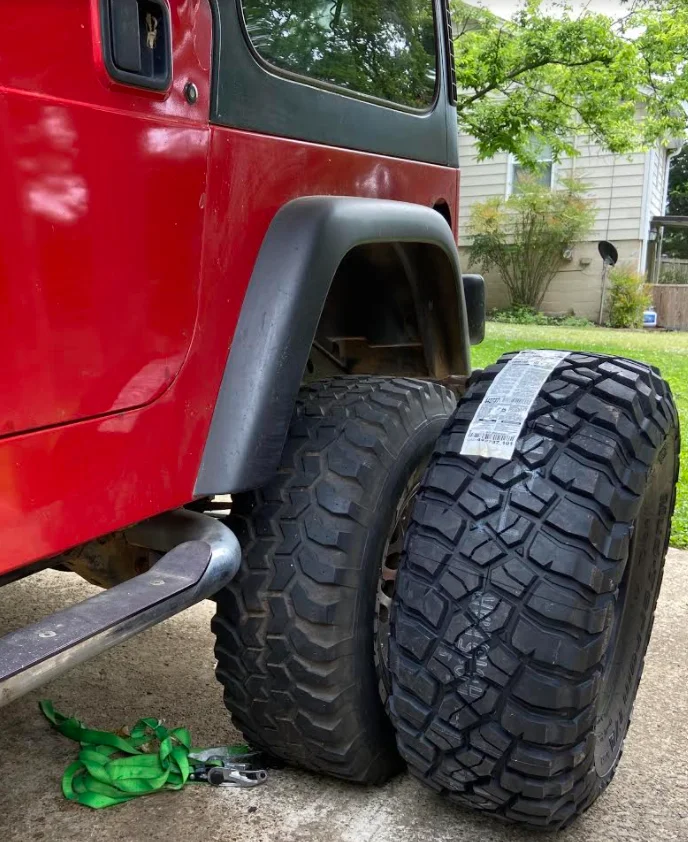

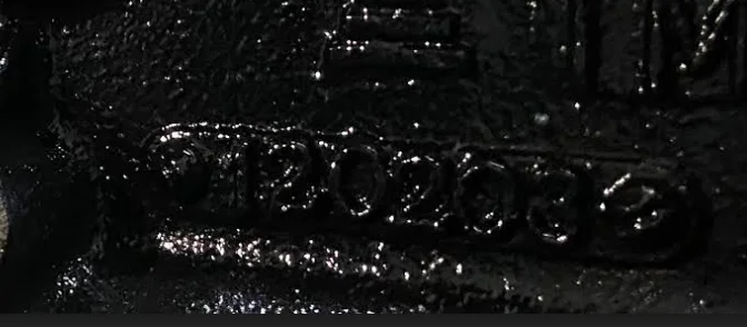

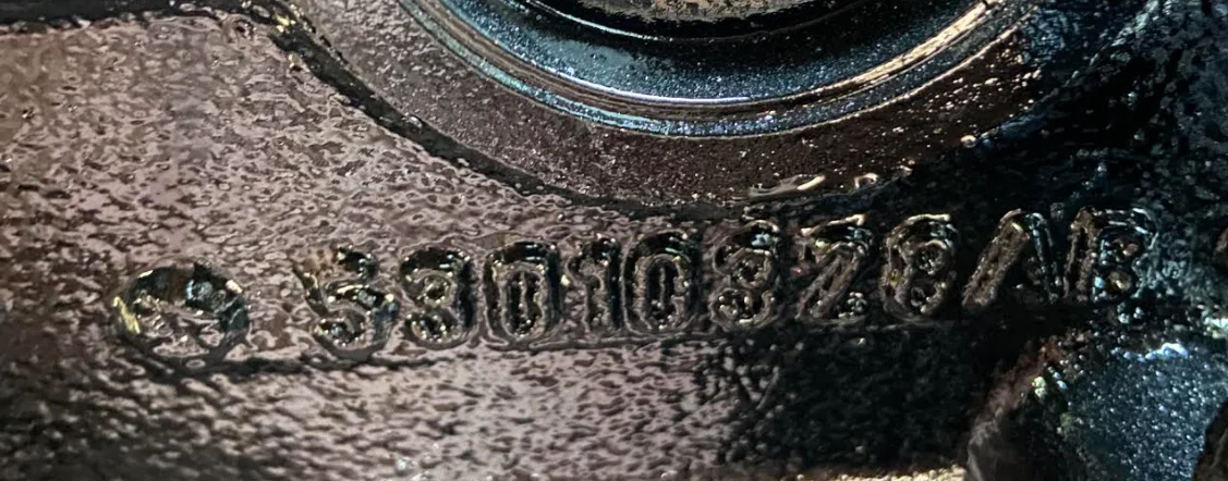

I just wanted to add an update. I was incorrect about the Engine year. It is a 2003 according to the Block numbers. Also, I wanted to add that my Transmission is an AX15 Manual and Transfer Case is an NP231 both out of a 1998 Wrangler Sport.
