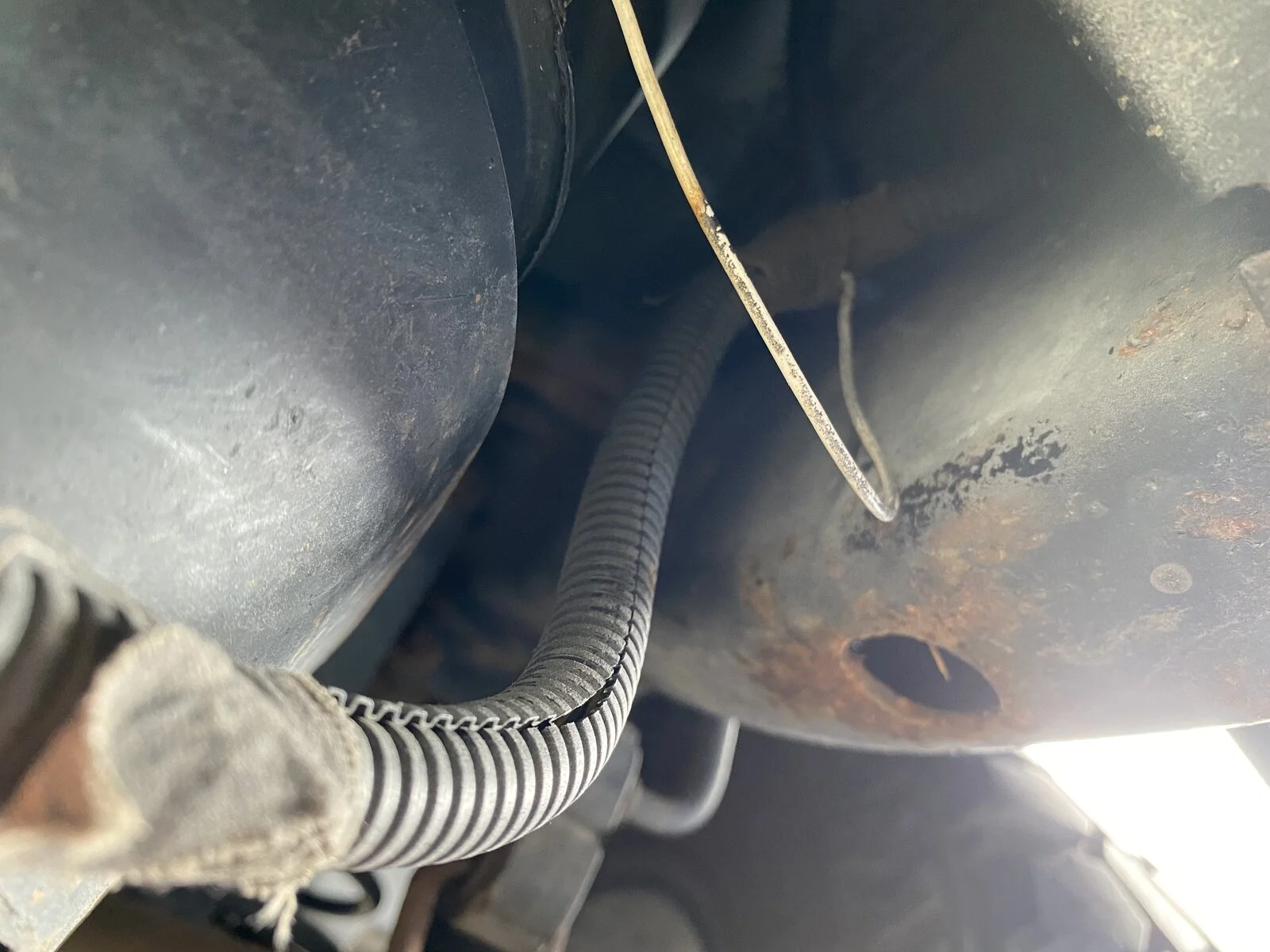

First picture is the trailer pigtail

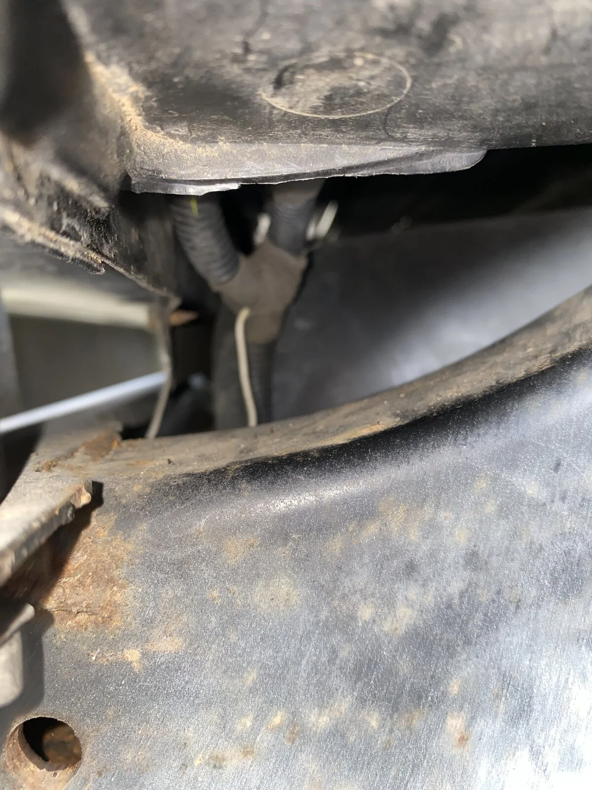

Second picture is following the pigtail from the first

The wire coming from the splice fork looks like a ground and is firmly attached up by the gas tank
I reread your previous responses and IF you can... trace the wiring harness for the passenger side to see if there is an oxidized harness connector.
