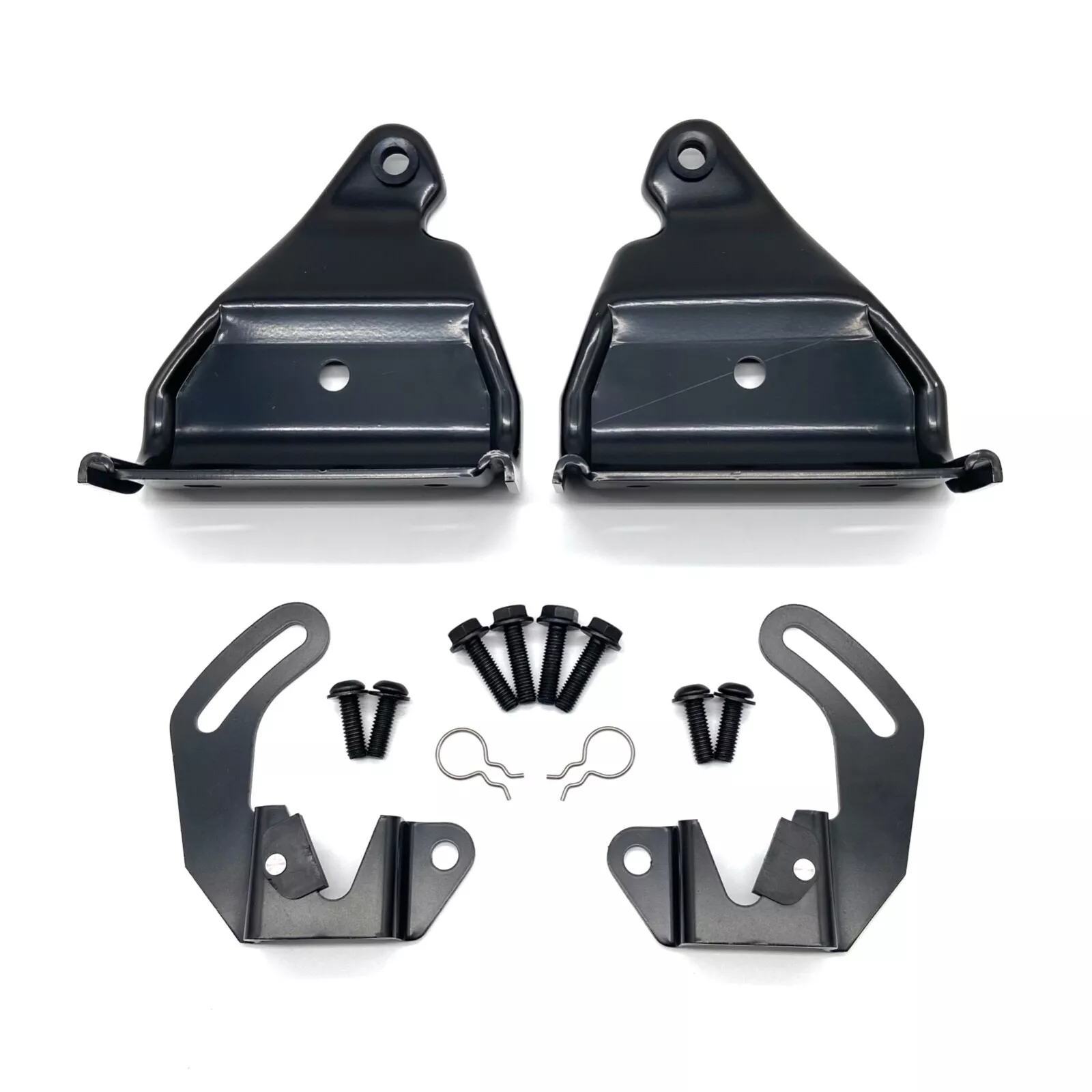

I purchased a complete set of brackets to install the rear seat in my 99. No instructions and the brackets are not stamped L or R.
Anyone with a pic showing how the brackets install? The hardware includes a couple rubber grommets that go somewhere.

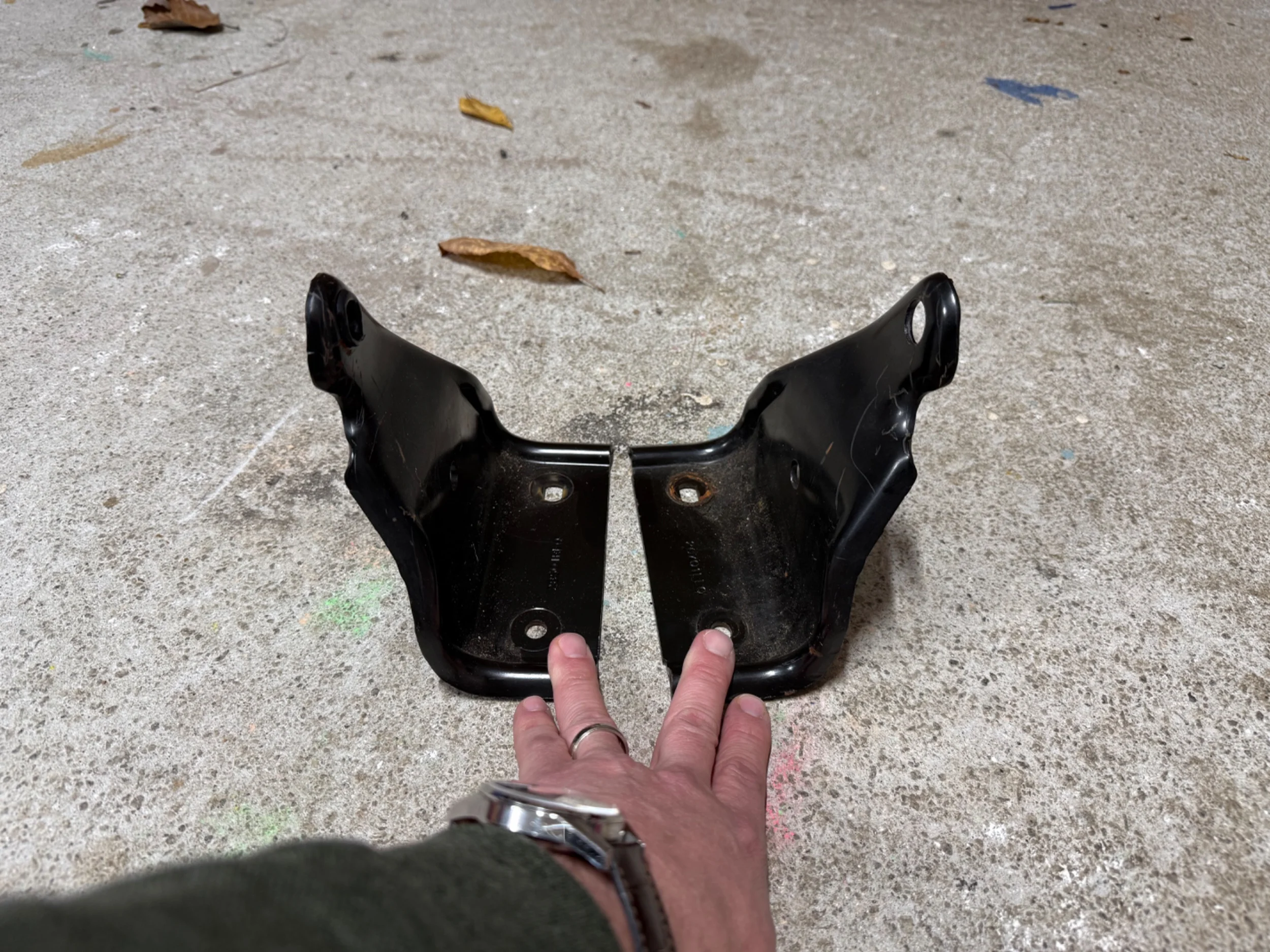

On my O2. Notches face forward and the grommets go in the bracket hole at the top to keep the seat base from rattling.
Thanks, I can figure out the rears once get the fronts in and the seat installed.

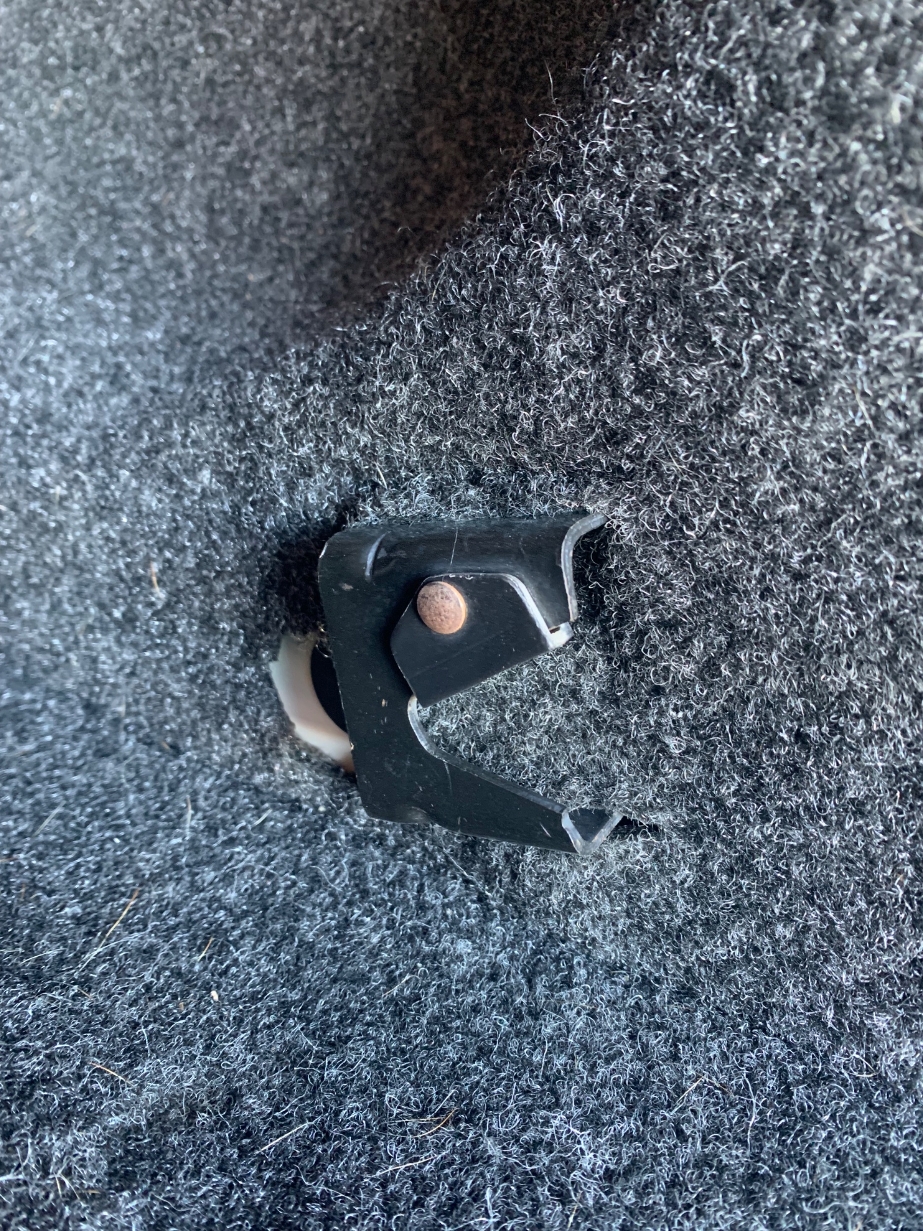

Rears look like this… notch to the rear.
Those look correct. The two mounting points are hidden behind the BedRug. Single hole on bottom, long curved slotted arm in top.
