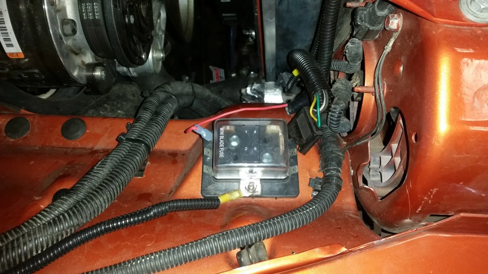

Somewhere 150 miles later I was trying to figure a way to make the tail lights work. I didn’t remember which pin in the MFS was the tail light pin and didn’t have any tester with me to help figure it out. Faye also suggested something along those lines about just hot wiring the tail lights. Maybe stop some place and buy a roll of wire and some tape. (those two items are now on my add to the tool box list) That really got me to thinking. I have a permanent towing wiring harness behind the front bumper that I plug into the coach for flat towing. I wonder if I can just run a wire from the battery to that harness. But wait. Just behind the right headlight I have added a fuse box for those thing I want hot all the time. Why not just splice into one of the pins? But wait again. When I found a rest stop and popped the hood then ran the tow wires back inside the grill I saw that the end of the harness would slip nicely over one of the hookup prongs of the fuse box. It slipped right on and Viola: taillight and dash lights.
