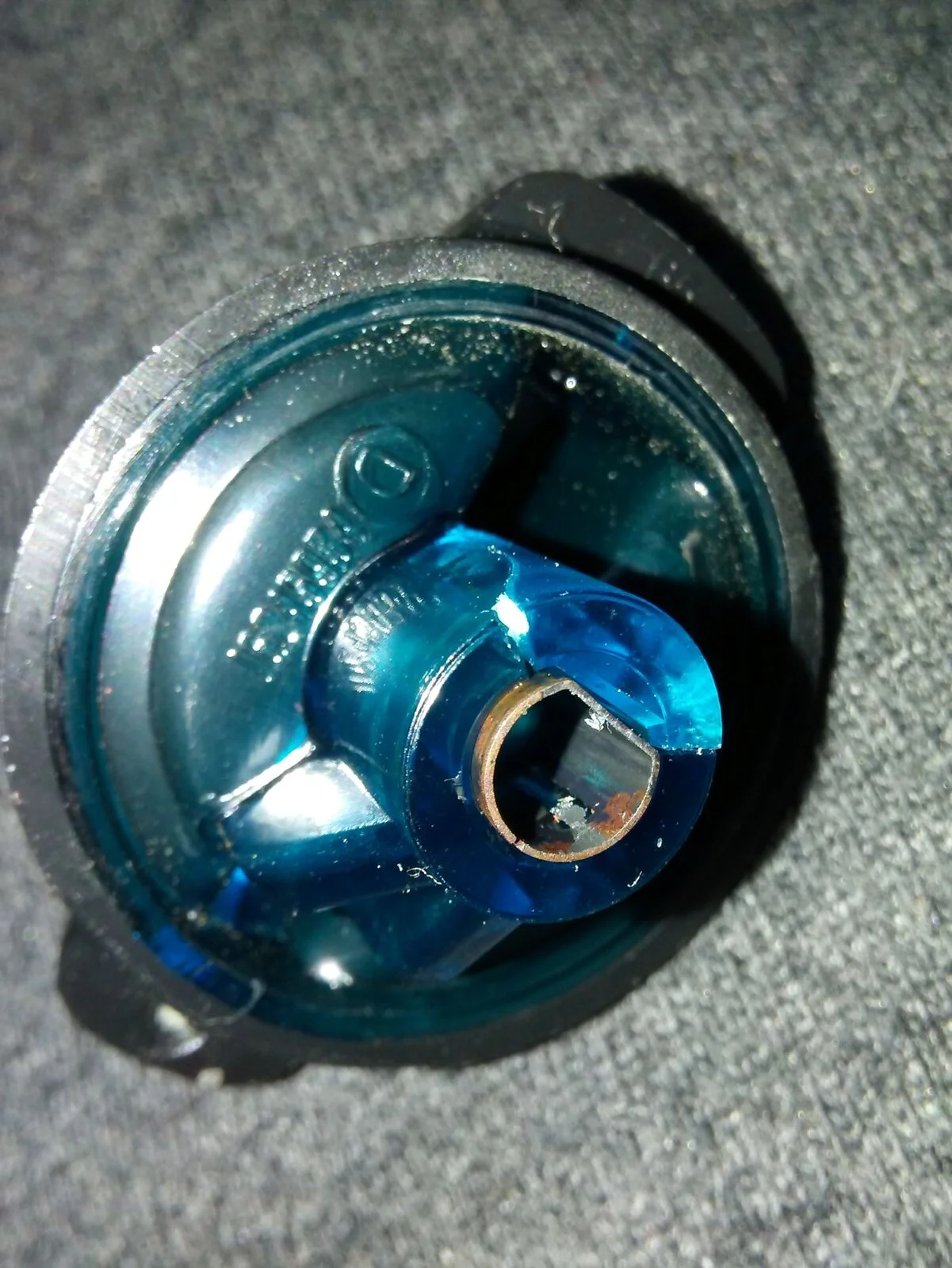

G Gary410007 New Member Original poster Joined Jun 13, 2022 Messages 7 Location Seattle Jun 23, 2022 #1 Why is my A/C always no no matter where my selector know is? Could this be the cause of parasitic battery drain?
TheBoogieman Disturbed Supporting Member Joined Jan 1, 2019 Messages 16,692 Location Charlottesville, VA Jun 23, 2022 #2 Knob broke from behind? Reactions: Jamison C and TJ4Jim
sab "Semper Discens" Lifetime Supporting Member Joined Jun 12, 2021 Messages 5,443 Location DITHOT Jun 23, 2022 #3 Gary410007 said: Why is my A/C always no no matter where my selector know is? Could this be the cause of parasitic battery drain? Click to expand... If whatever is wrong is keeping the A/C clutch engaged all the time, yes, it could. With your TJ off, check for 12V at the A/C clutch. If you have it, you'll then need to diagnose why.
