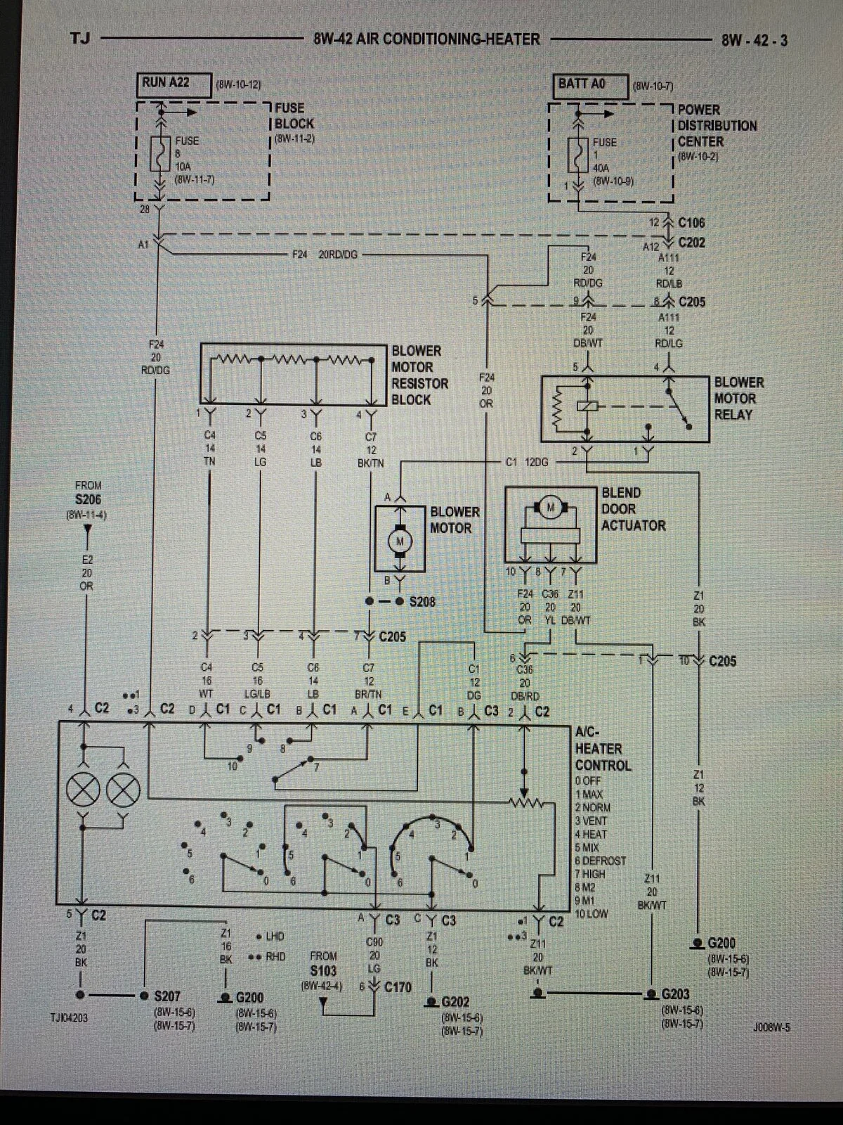

A/C system not working on 2000 TJ
a/c compressor cycles, 134a pressure good. Replaced high pressure s/w no help.

You will need to do some electrical troubleshooting.
