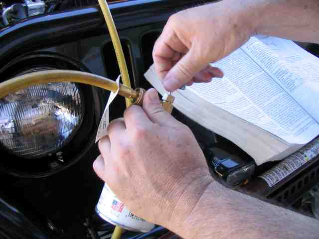

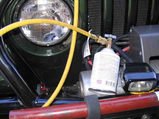

The remaining hose that is attached to the gauge manifold is connected to the refrigerant container. Alan had a partially used can, about 3 ~ 4 ounces remaining, already attached to the hose so I set the can in a safe place to keep it out of the way. The valve on top of the can will be opened if we determine the system is low on refrigerant.

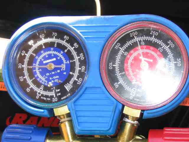

It was time to start the engine, set the A/C to recirculate, and put the blower fan to high the setting. After several minutes of operation, I checked the pressure gauges. As shown above, the low pressure gauge was 30 PSI and the high pressure gauge was about 205 PSI. The center vent temperature was about 57 degrees.
As we suspected, the system appeared to be a little low on refrigerant. It wouldn't take too much to bring the numbers up into the proper ranges by adding a little refrigerant.
With the engine and compressor still running, Alan opened the valve at the top of the R-134a container. I saw an immediate jump on the low pressure gauge. Alan said this is normal as we are now seeing can pressure on the low pressure side. Immediately, the can began to get cold....a sure sign that refrigerant was being transfered from the can into the low pressure line.
To speed the process along, I set the hand throttle to about 1400 RPM. After another 30 seconds or so, Alan closed the valve on the R-134a container so I could get an accurate reading on the gauges. We were better on the numbers but still a bit below what the manual said we should get, so the valve was opened again to add a bit more refrigerant.

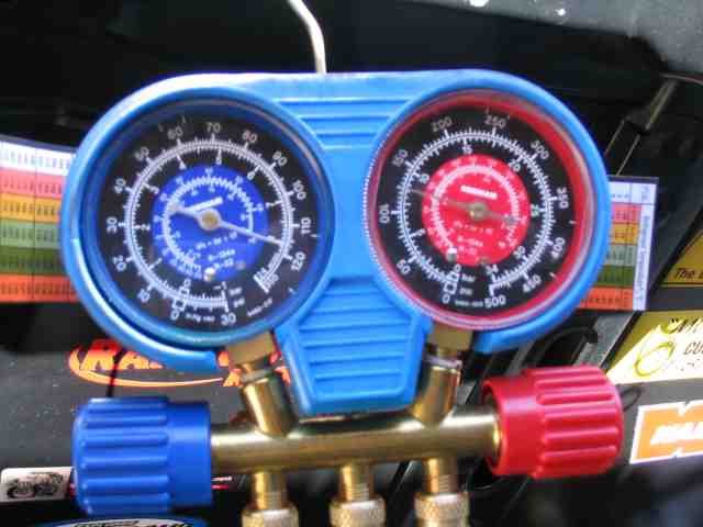

I was keeping an eye on the digital thermometer that we had pushed into the center vent. It was slowly dropping as we added refrigerant. When it hit the 45 degree point, Alan closed the valve on the R-134a can and I took another look at the gauges. That was better.....low pressure was hitting about 41 PSI and the high pressure reading was a bit over 250 PSI. We agreed that it was pretty good and I was happy with the numbers we were seeing. Yeah, we probably could have added another ounce of refrigerant, but 45 degree air was OK with me.
The valves on the gauges and couplers were closed (trapping the R-134a refrigerant in the hoses) and I removed them from the A/C service ports. Alan shook the R-134a container and estimated that there was an ounce or so left which meant we added about 3 ounces to the system.
That 3 ounces probably doesn't seem like much, but as you can see, it was enough to bring the system into spec and drop the temp by 10 degrees. An important point here....it would be VERY easy to overfill the system with just a 12 oz. can of refrigerant if it were in the same situation as mine....a little low but still making cool air. Alan said that the old R-12 systems were more forgiving and could tolerate being over filled more than the R-134a systems. I am glad he had the gauges available as it provided us with an accurate method by which to accomplish this maintenance work.

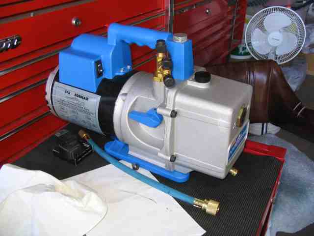

If the A/C system has a major leak or an item is replaced due to failure, a good vacuum pump is needed to completely evacuate all of the air from the system before refrigerant is added. Alan said this one will pull a vacuum down to about 20 microns (which is about as void of air as you can get without getting into some serious equipment).
In order to accurately determine the amount of air left in the system when the vacuum pump is running, Alan uses a digital gauge that is thousands of times more accurate than a mechanical dial gauge. After the vacuum pump has evacuated the air from the system, the pump valve is closed and this gauge monitors for any leakage. The LEDs on the gauge light up and indicate just how air tight your system really is.
