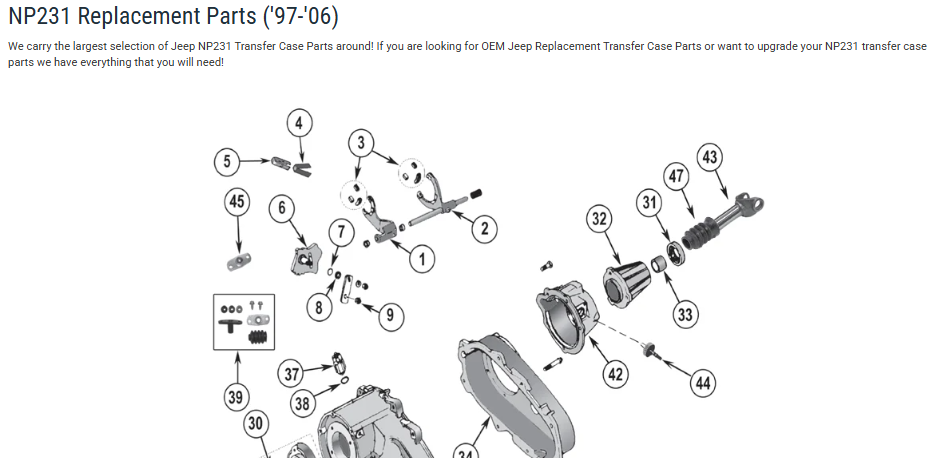

4) Why do some NP231's not have tail cones? I just have the tail housing but no tail cone. In this photo, how do I tell if seal 31 is for the tail housing (item 42) or the tail cone (item 32)? It also doesn't have the oil slinger that I have (Crown number 5016615AA)
