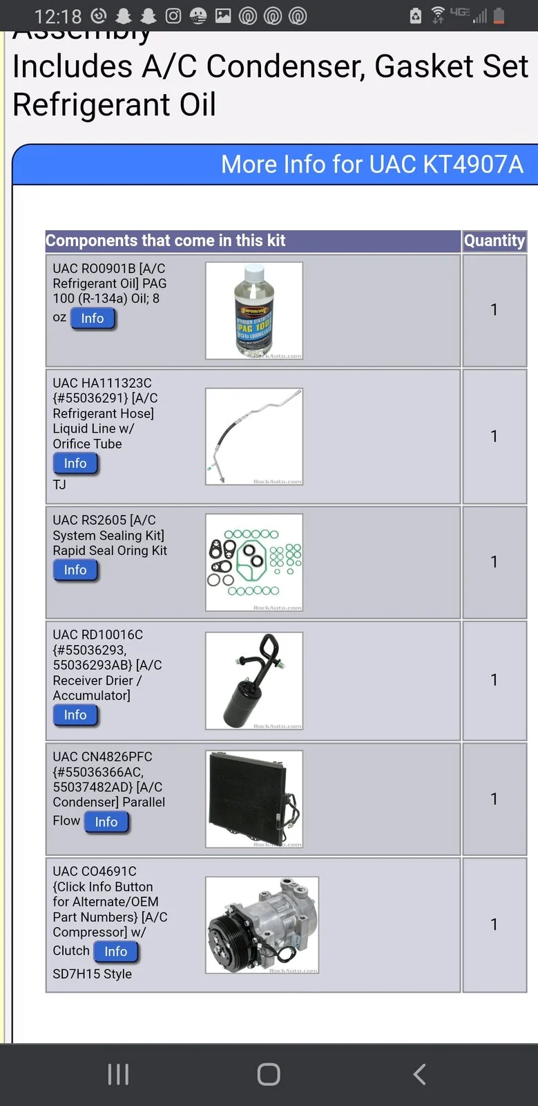

I found this kit on Rock Auto, does it have everything I need?
There's no way I'd try to install a junkyard A/C. There are far to many things that could go wrong, resulting in a bunch of money spent to cobble a system together. In terms of completeness, the best kits I've seen are available here. I've installed their parts, along with a couple systems. Their customer service has always been exceptional, when I had parts or installation related issues.

I agree with Irun that a complete kit for your model year would be a better choice...
