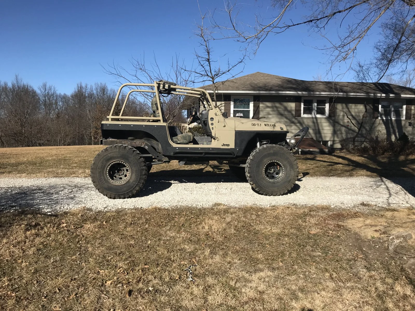

View attachment 29948 Has anyone added disk brakes to rear and not have to up scale on the booster and master cylinder? Will the stock booster/master handle it?

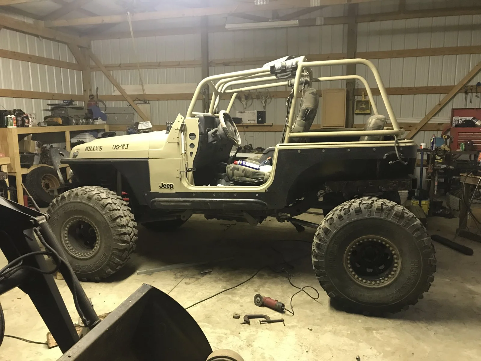

i have everything here for the 11” drums so i think I’ll run them for now. Appreciate all the feedback tho.
Also picked up some 4” lift coils for the rear to sit the ride height lower than my 6” coils. Today I’ll start the 44hp swap and stretch the front
