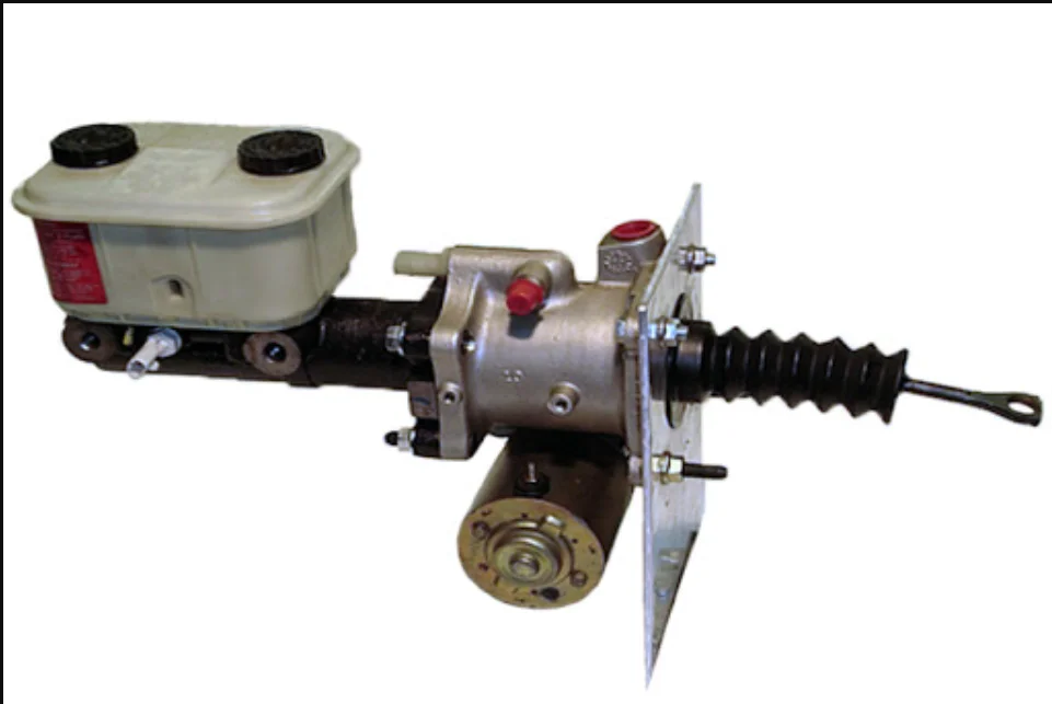

The Hydromax is basically a hydroboost with an electric backup in lieu of an accumulator backup. The advantage of the electric being that it can function repeatedly in the event of hydraulic failure. The disadvantage is of course that the electric backup won’t provide nearly the same level of boost for the first press or two as an accumulator.
Another interesting thing I came across a while ago is what appears to essentially be an electric hydroboost:
https://www.speedwaymotors.com/Comp...r-Booster-Master-Cylinder-Disc-Disc,8335.html
Instead of taking fluid from the power steering or other hydraulic supply, it takes fluid pressure from a separate electric pump and accumulator.
Not sure I’d trust it myself, but if the motor/pump/accumulator is sufficiently reliable, it should function comparable to ordinary hydroboost.
