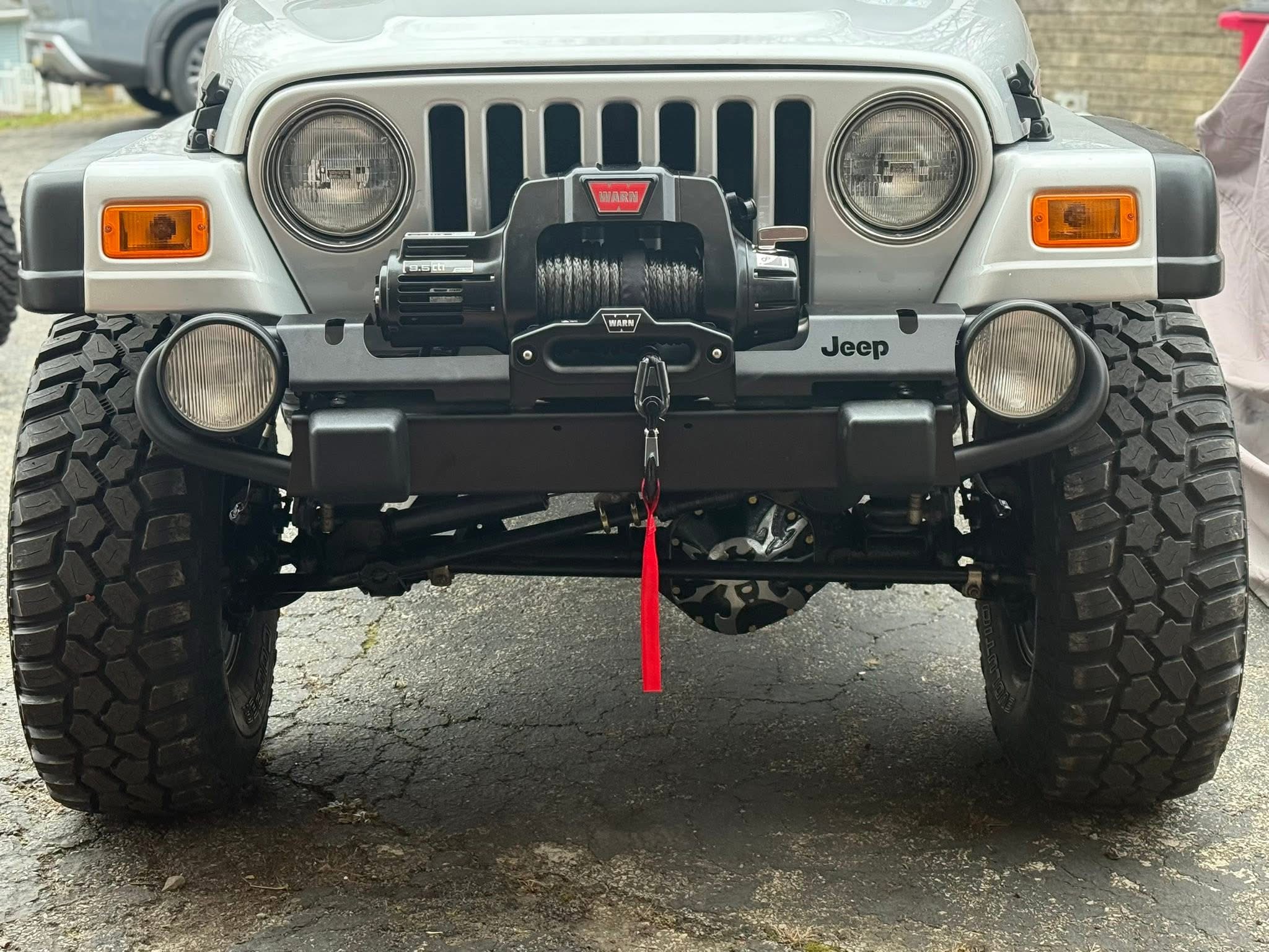

I just got lucky and found the aev Mopar rock crawler front and rear bumpers for sale. I found instructions online for the front bumper but am having no luck for the rear bumper. Can anyone fill me in if I need anything special or does it basically bolt right up? Ty
It’s been a while since I had mine on a Jeep but if I remember correctly nothing special is needed. Basically the same nuts and bolts as the stock rear bumper.
I can confirm this. You will need to reverse one of the bolts in the rear only for clearance but it uses the same hardware and mounting holes.
No issues bolted right ip
