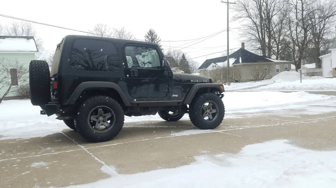

They are about 5.25" from AEV, so with the spacer, they sit around 4" of backspacing. Its what I'm running.
86511
86512
Reactions: psrivats
Any rubbing?
I get a little, turned one direction because my steering stops are set slightly differently, right to left, from the factory. Only at full lock though. I've tried adjusting...but they are pretty seized into the knuckle. Don't want to break them. I just back off when I hear the tire catch the control arm.
