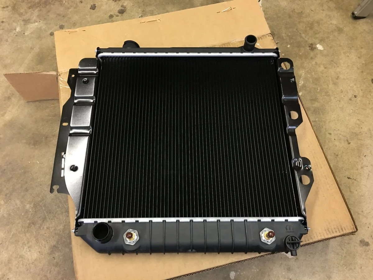

If your fan clutch is ok (spins readily will cool, stiffens when hot), I suspect either a bad/clogged OE Mopar, a poorly designed aftermarket radiator, or a bad water pump. And if you used tap water to mix with the coolant, your radiator might be clogged with hard water deposits.
Ok, thanks for the tips on the fan clutch. Can't say on the manufacturer of the radiator, looks like an old Mopar but is pretty old based on the rusty brackets near the top, isn't leaking anywhere currently.

I just recently bought a MOPAR radiator and it has the MOPAR logo molded into the plastic right above the drain. You might be able to look there.
