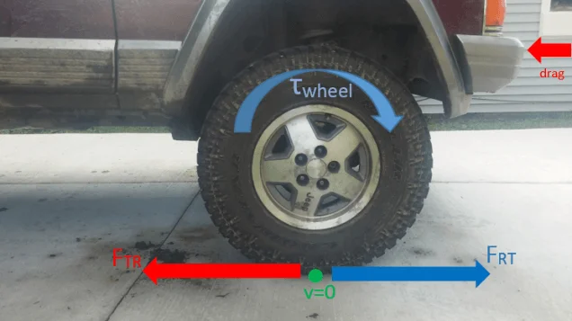

The reason why your car moves forward at all is because the ground is actually “pushing” the car forward by reacting to your wheel’s force against the ground. This is Newton’s Third Law: The force that the tire produces on the road is greeted by an equal and opposite force of the road onto the tire:
As shown in the image above, your axle produces a torque, τwheel, on your wheel. As we know, this torque is simply the engine torque times the crawl ratio. To determine the force the tire imparts on the road, FTR, we need to recall that torque is equal to a force times a distance. Think of this like your wrench: if you produce a force on a long wrench, it will produce more torque than imparting that same force on a short wrench.
The torque produced at the wheel, then, results in a force at the ground equal to the torque divided by the tire radius. This means bigger tires yield less force. And since mass is remaining unchanged, Newton’s Second Law (see rearranged equation above) says our acceleration will drop. This is why you want to regear when you have bigger tires: you want to increase τwheel to keep the force, Frt high enough to provide decent acceleration.
