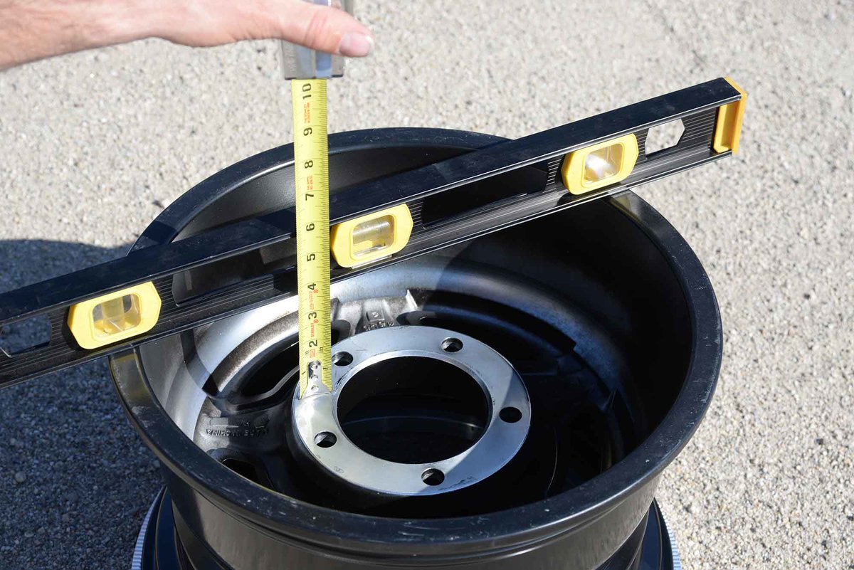

This is how you measure:
Well SOB, I looked at them all and didn't see that offset... Good find! I will pull the wheels in a couple days when I get my wheel spacers and then measure the actual backspace. From what I can tell with them on the Jeep is they're closer to the 4.5" measurements
