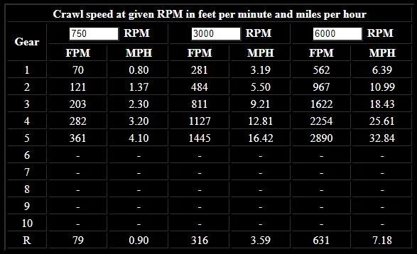

NV3550 w/4.88 w/ 5:1 - Top speed 16mph @ 3000 rpm 5th gear

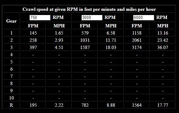

32rh w/4.56 w/3.8:1 - Top speed 18mph in 3rd gear @ 3000 RPM

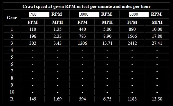

32rh w/4.56 w/5:1 - Top speed 14 mph @ 3,000RPM

My guess is AA recommends the 3.8 on the 32RH because it allows for a higher top speed while still having the advantages of a lower geared box than the NP231. The 5:1 would likely be too slow for the 32rh especially if you wheel in conditions where wheel speed is nessary.
