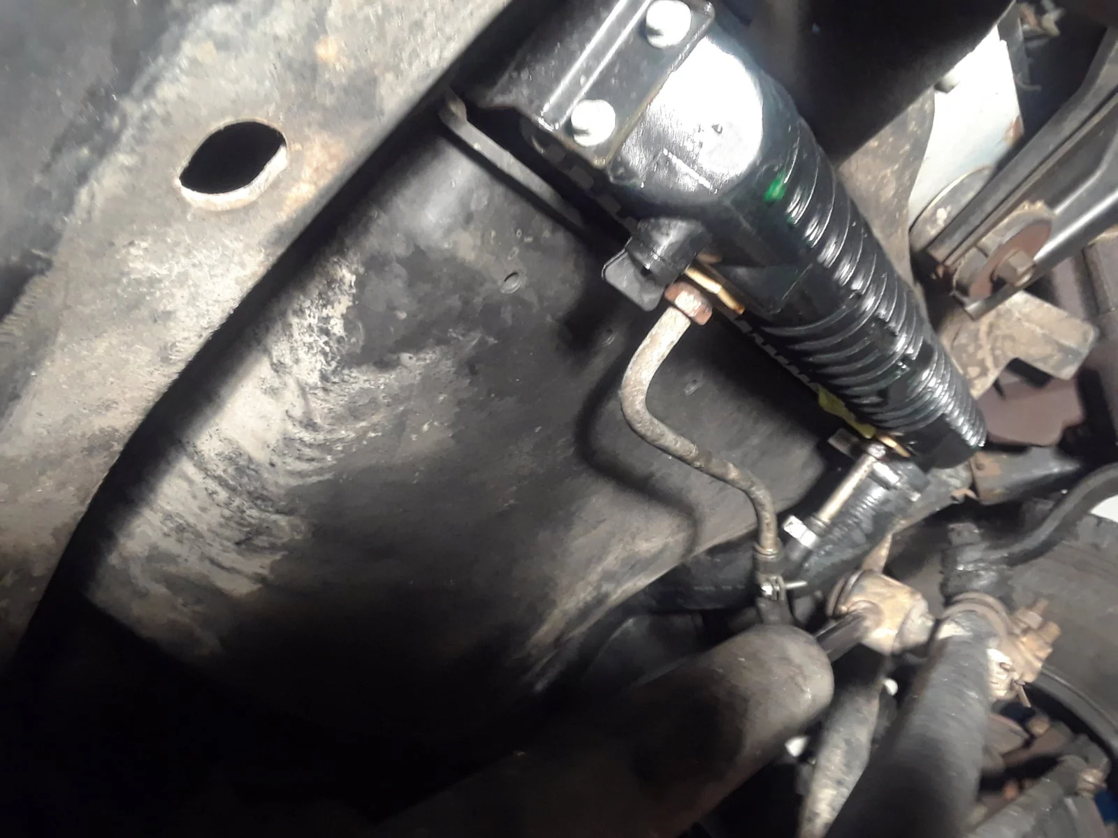

Installing a tranny oil cooler. I am plumbing this cooler to cool ATF fluid after it leaves the radiator.
Question: which AT line is incoming fluid from tranny or which line returns fluid to tranny?
Thanks in advance
The output side of the cooler for your model year is on the passenger side. That is the side that returns the ATF back to your 30RH transmission.
