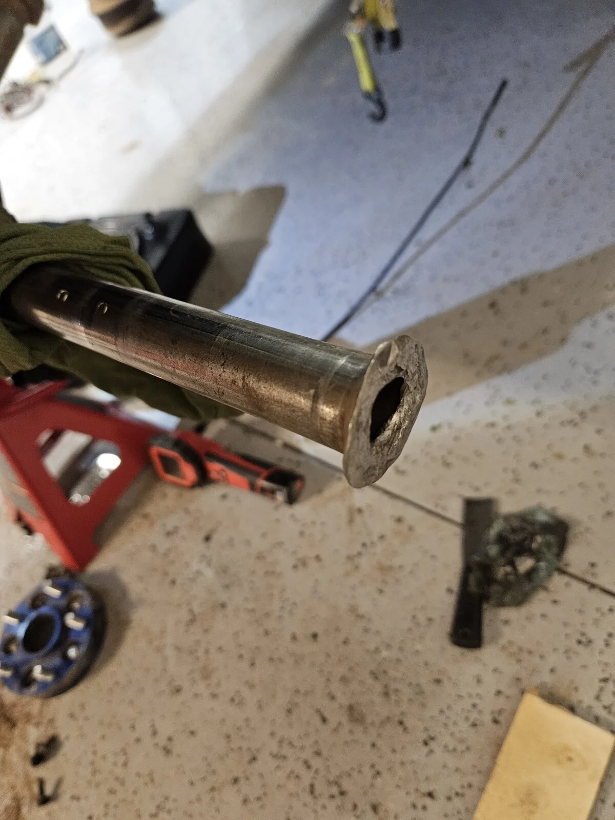

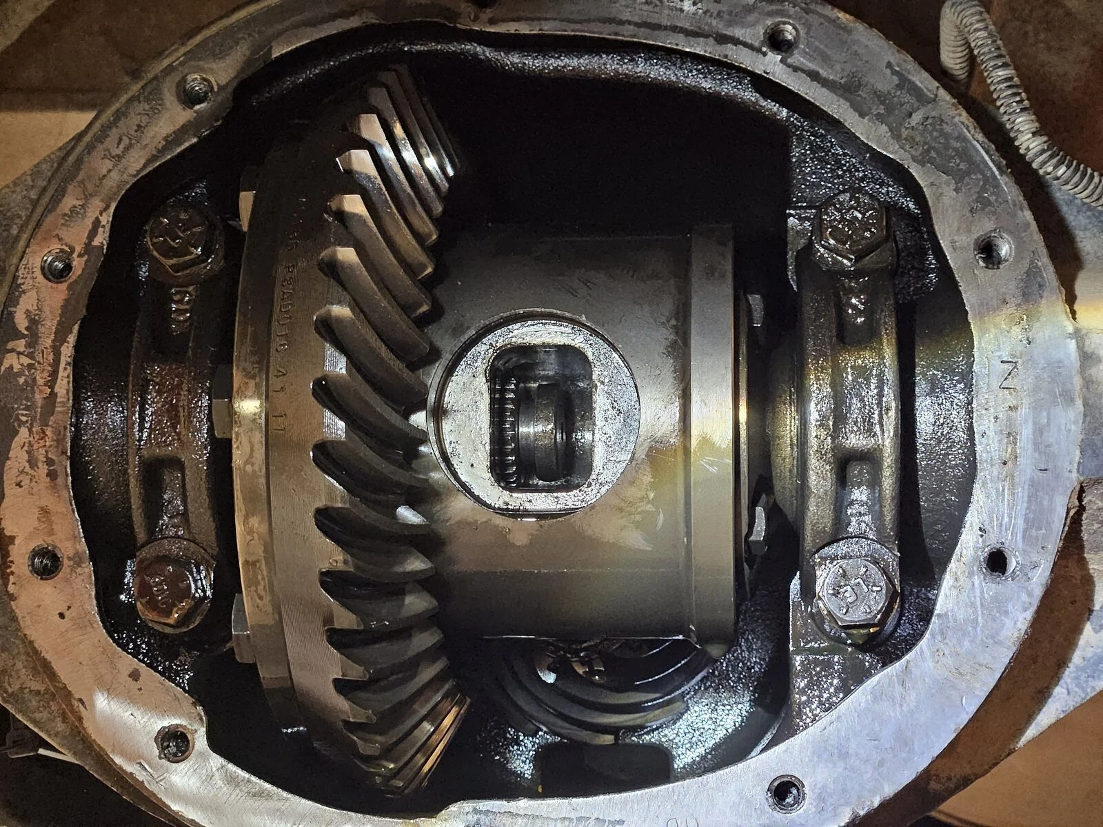

Yeah, it definitely doesn't have 1/8" of play in it. The passenger side rear axle shaft grenaded at the splines, and it was pretty easy to get it out. Unfortunately, when it broke it took about 1/4 of the circumference of the bearing race (closest to the LSD) with it...which is why I'm trying to remove the (hopefully) unbroken shaft. Once both shafts are out, I plan to remove the LSD and see if bearings can be replaced and housing can be salvaged.
