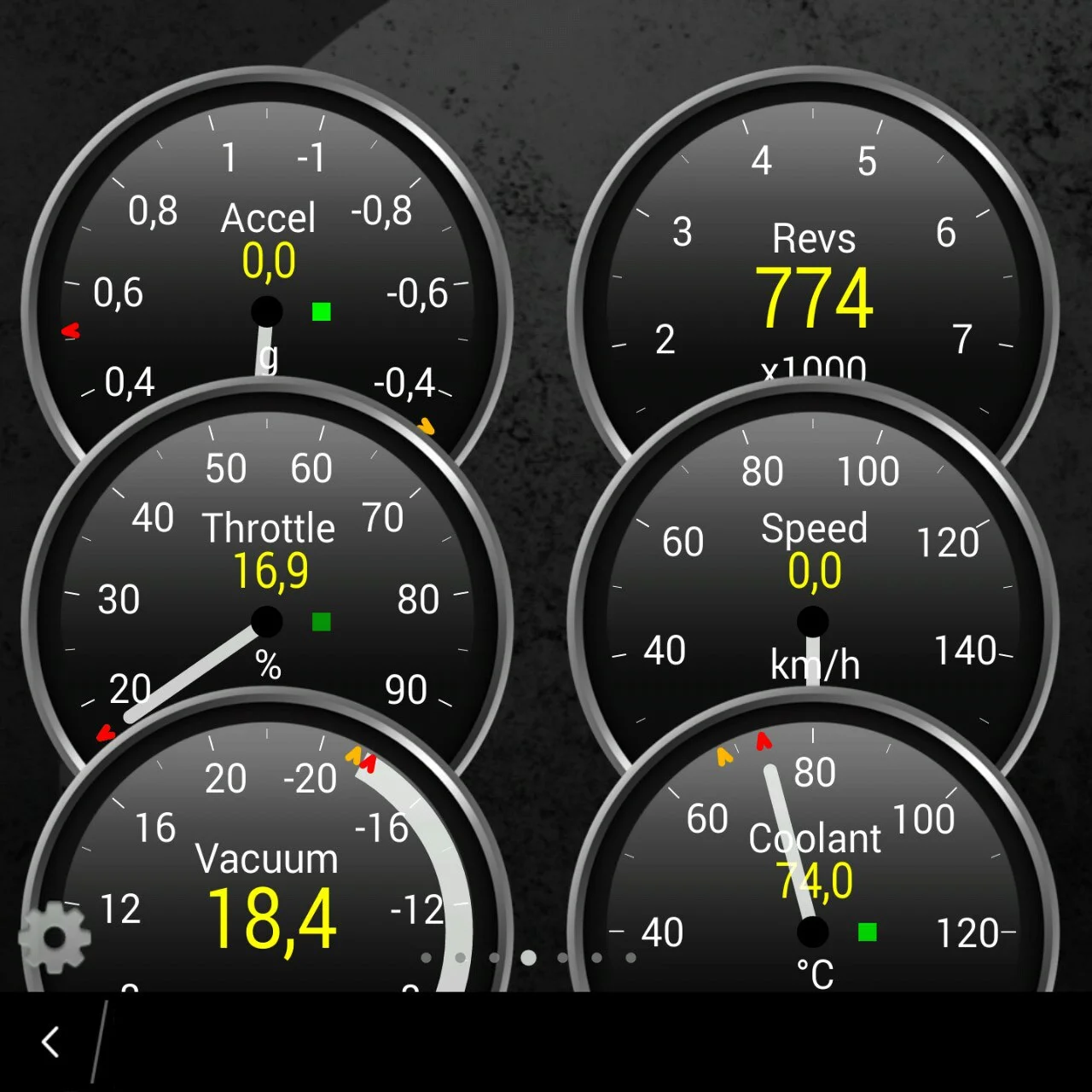

Torque:
Idle - TPS 16.9 % / Vacuum: 18,4

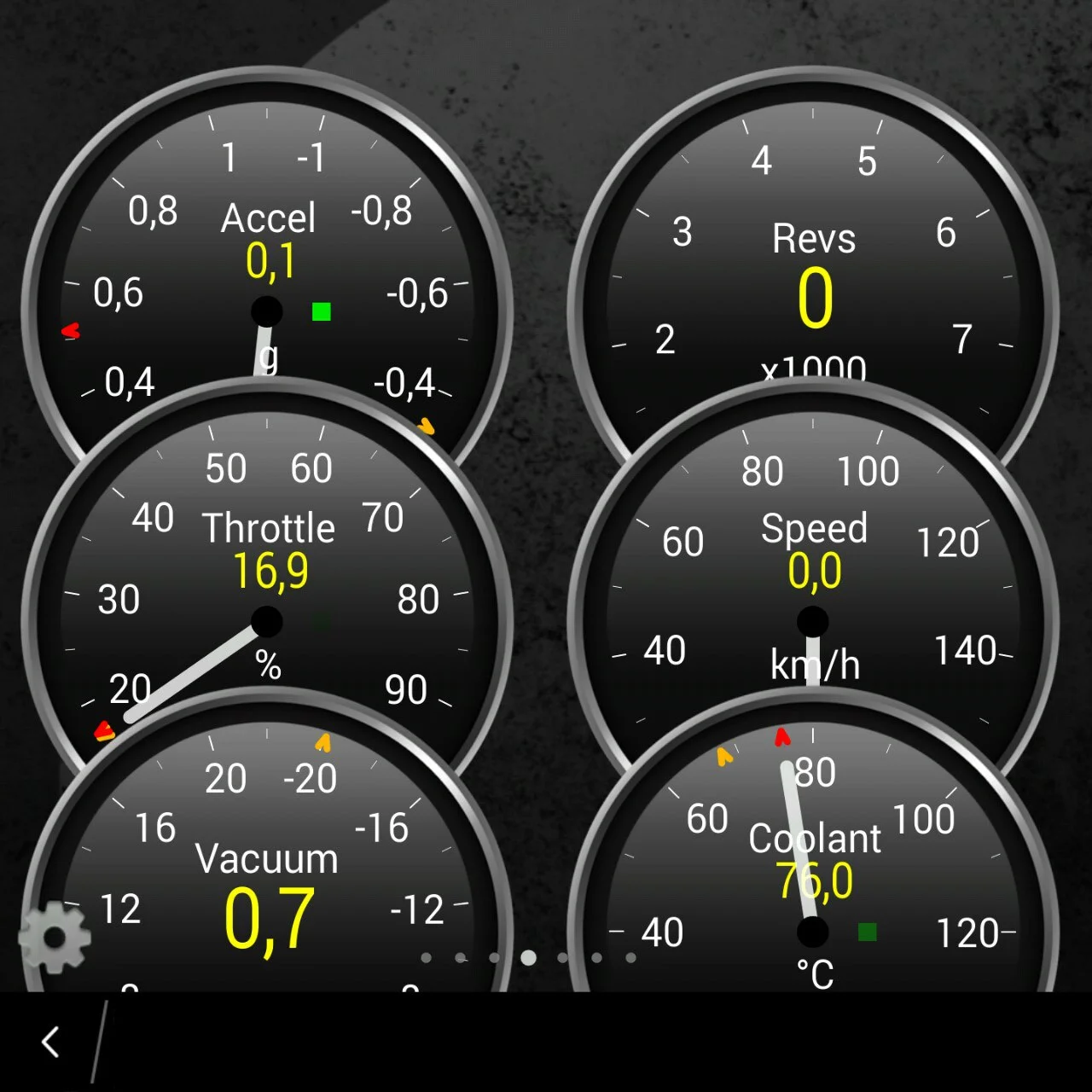

no idle, only Ignition ON
TPS 16.9 %
shouldn't the value be 0 % ?
Perhaps the TPS is faulty?
Can I clean it?

Can you clean a TPS? Yes. But not the part that fails. The TPS is a potentiometer, and all that is is a band of plates that increase or decrease resistance and report that R value to the PCM as you move the pedal. That's inside the sensor, and it is attached exterior to the throttle body. It doesn't come in contact with air or fuel like an IAC valve, O2 sensor, MAP sensor, ETC. It doesn't get dirty. It fails, your symptoms are more in the IAC circuit. A clean IAC valve doesn't mean it's an operational IAC valve.
Just like the MAP sensor, back probe the signal wire and ground your voltmeter. Move the pedal lock to lock looking for dead spots in the voltage range. While the car is running, if the RPM's don't fluctuate or you don't get any stuttering it's likely not the TPS.
