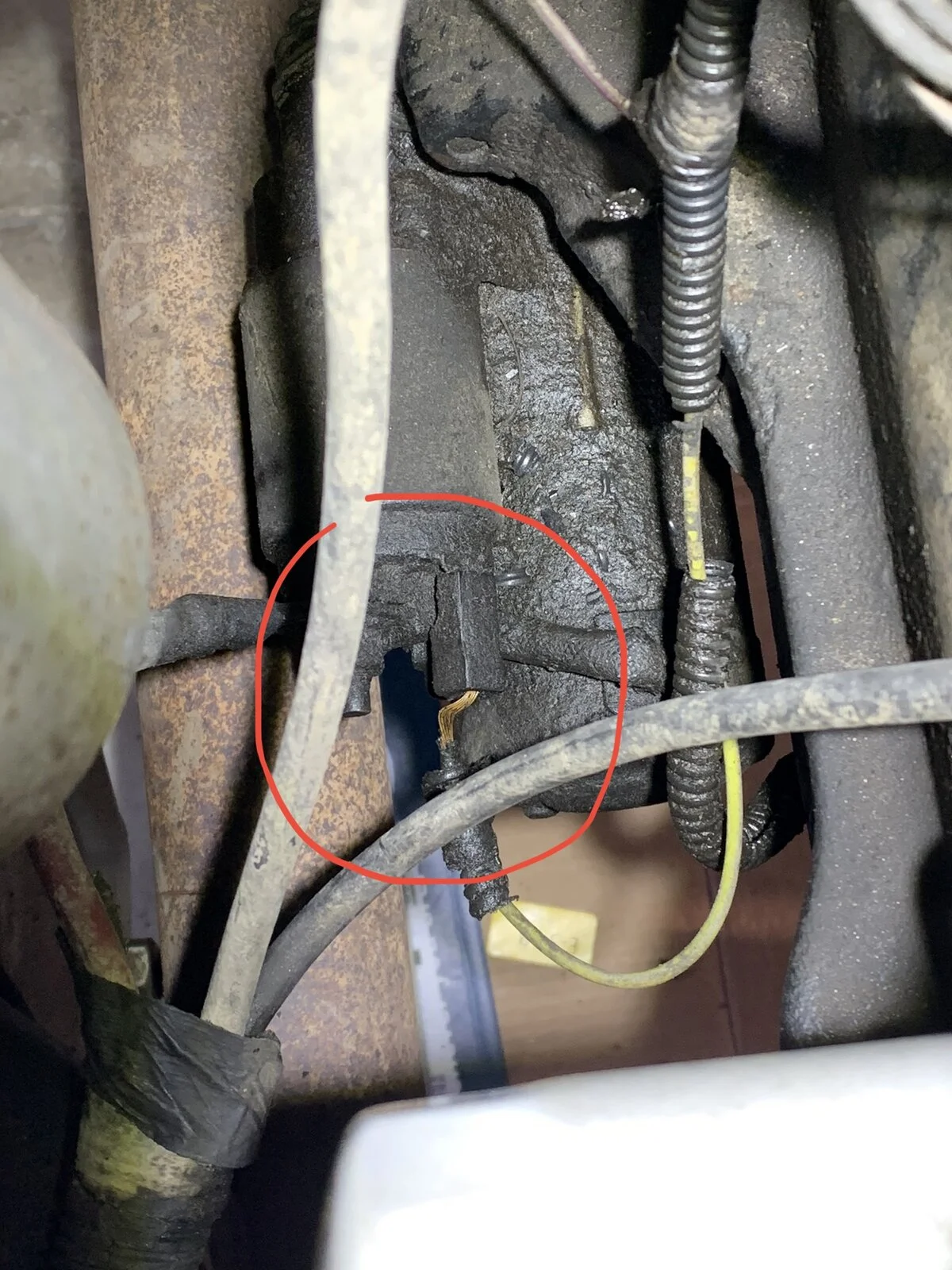

I found this bare wire leading to the transmission (starter?) on the passenger side. 05 TJ w/ 6 spd manual. Had a nice oil leak and wear/tear of the years has left this wire bare at the connection, as well as destroyed the plastic wire conduit.
Question for y'all: how would you go about cleaning engine oil off of the bare wire before wrapping it up in electrical tape?

What he said about heat shrink is probably the best way to go, but I'd just use electrical tape myself. I would maybe get a can of engine degreaser from napa and then a can of electrical cleaner as well. Maybe pull the thing off of the starter and also make sure the wire is all the way into its housing, because it may have pulled out a bit which can cause some grounding issues. But I'd use the engine degreaser, wipe it up, and let it dry for a bit before wrapping it
Definitely disconnect the battery when you do. I had the bright idea to leave mine hooked up one time and accidentally shorted out the solenoid and it kicked the starter on lol luckily it didn’t grab ahold of anything while laying on the frame rail but it did startle me lol

I had the same thing with 6” or so of bare wiring. I spliced in new wiring w/ a female spade heat-shrink connector then wire loomed it.

After fixing the wire itself, rip off that old hardened cracking wire loom (it will probably just crumble away). Get some new stuff at Harbor Freight (cheapest place for "wire loom" aka "protective wire wrap").
