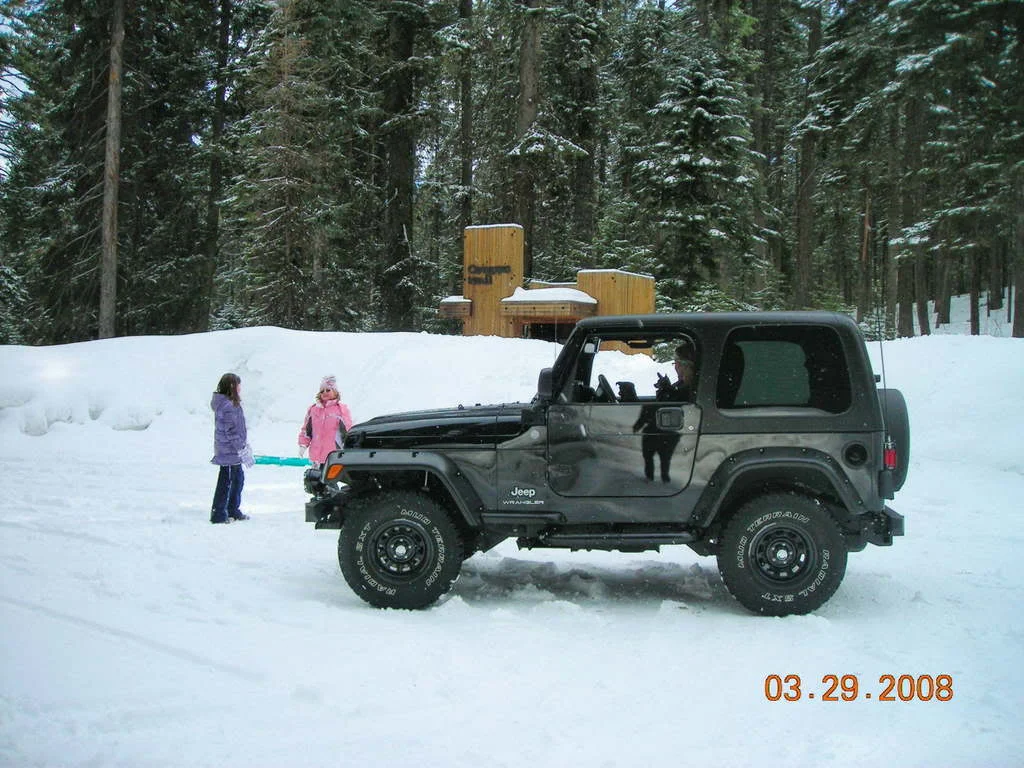

Back when I bought my Jeep, the first mods was a set of 2" BB spacers, Skyjacker hydro shocks, and 32x11.5x15 on 15x8 steel wheels with 3.75" backspacing.
When I started going off road those tires rubbed pretty bad on the fenders. So I added a 1.25" JKS body lift and a 1" mml to go with it.
That did the trick for running 32" tires off road. On road only, they were fine. The JKS BL/mml is all that remains on my Jeep today.
Here is an old pic of it with 2" BB, 1.25" BL, and 32x11.5x15 tires.
