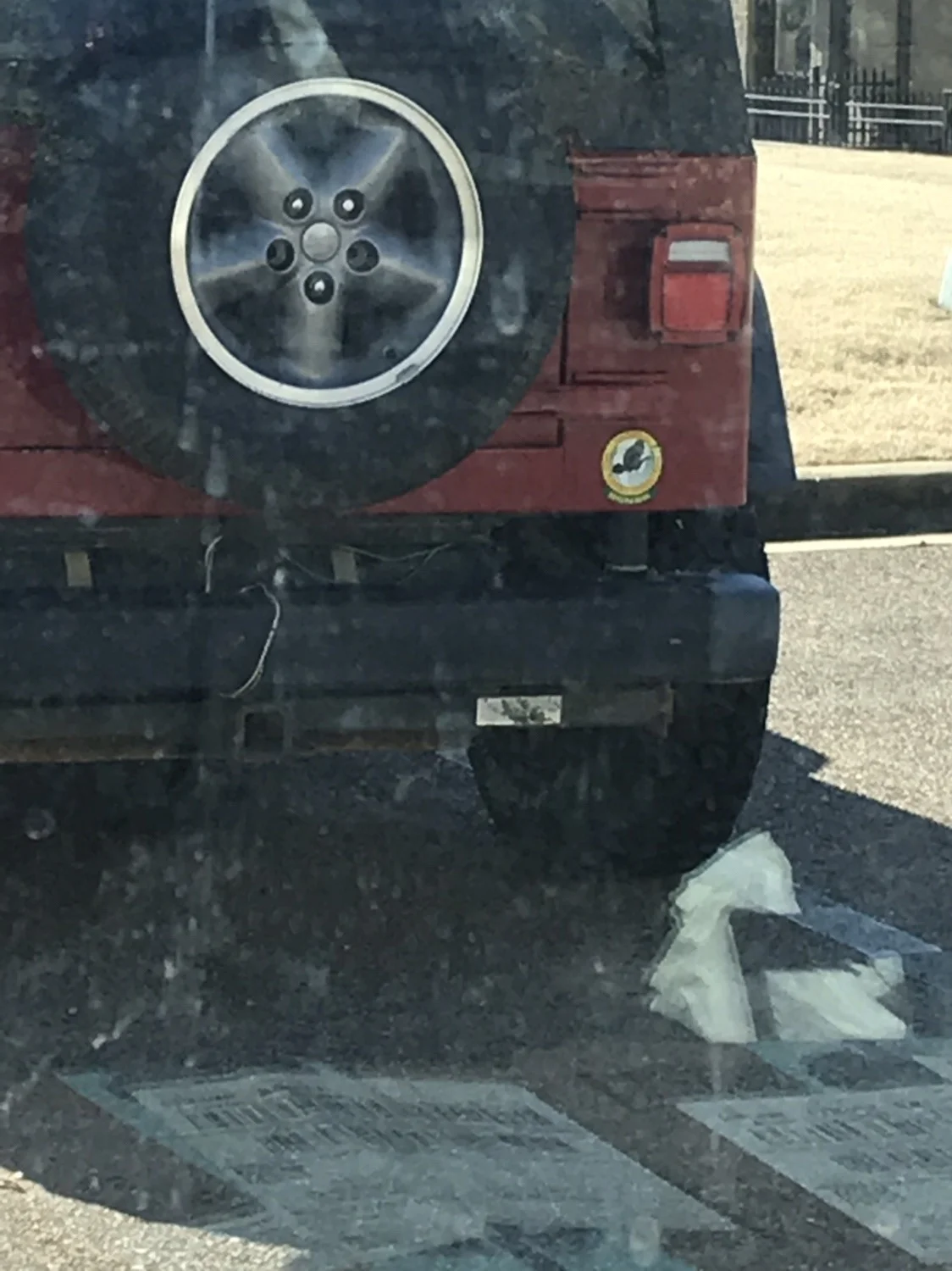

Replacing that 3" with a 1" to 1.25" body lift would be a great idea but you'd have to undo some other likely mods that were made just so that 3" (a stupid height) BL could be installed. The tcase shifter and gas filler neck assembly for sure, likely the transmission shifter too.
