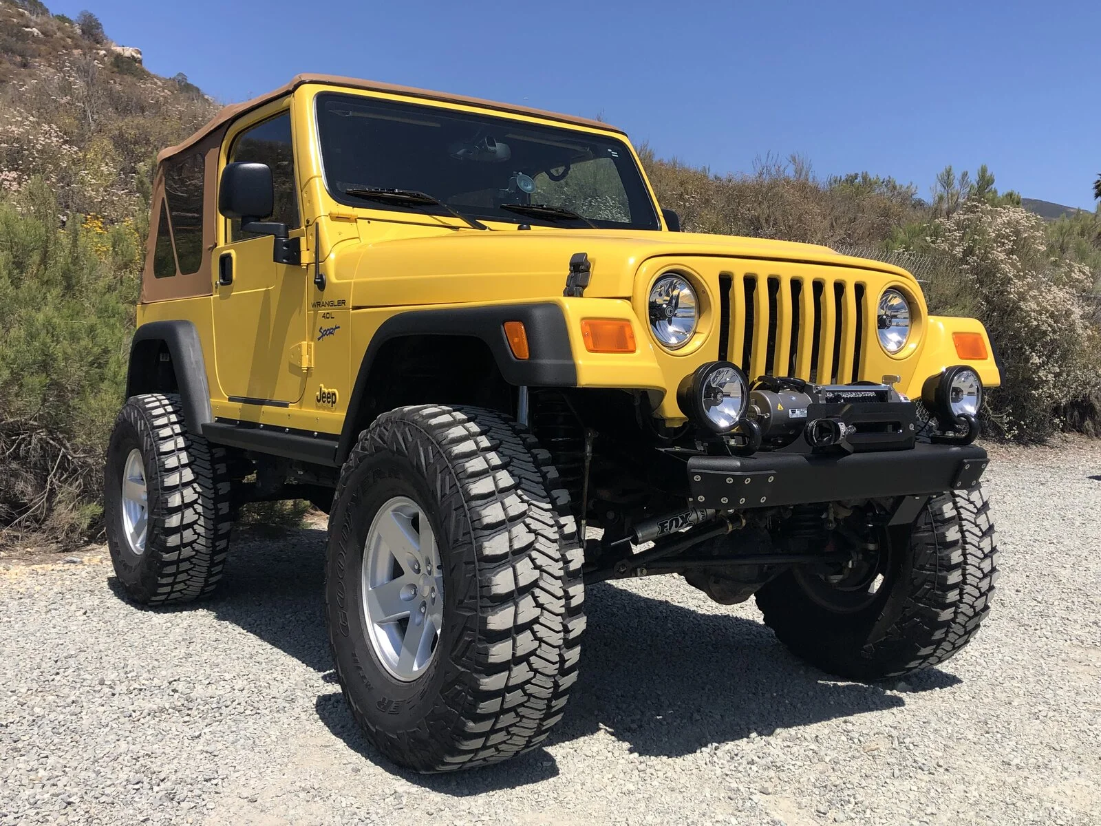

Today the stuff I bought is about $53 out the door at O'Reilly and how does six years pictured above turn into 2-3? I'm sure the Omix flares are a good option but aren't they obviously a little worse than the factory ones as far as quality?

The OMIX I installed fit great. I didn't notice any quality degradation from factory. No one knows about the longevity of painting a set of factory exactly, since it all depends on prep (owner dependent) and paint (which is factory dependent on quality and consistency of product.) No one knows about the longevity of OMIX unless you know someone who's had a set for 15 years, which is highly unlikely. However, if you start with a fresh set, you can always paint them later if you're not happy. As I said, this is my 0.2 cents. If you don't like it, it's not much loss. All I can say is me and my twins were very happy. It's your decision. I researched SEM paint prep procedures and costs and decided it was NOT worth it to me to go that route. Every owner has to decide for themselves.

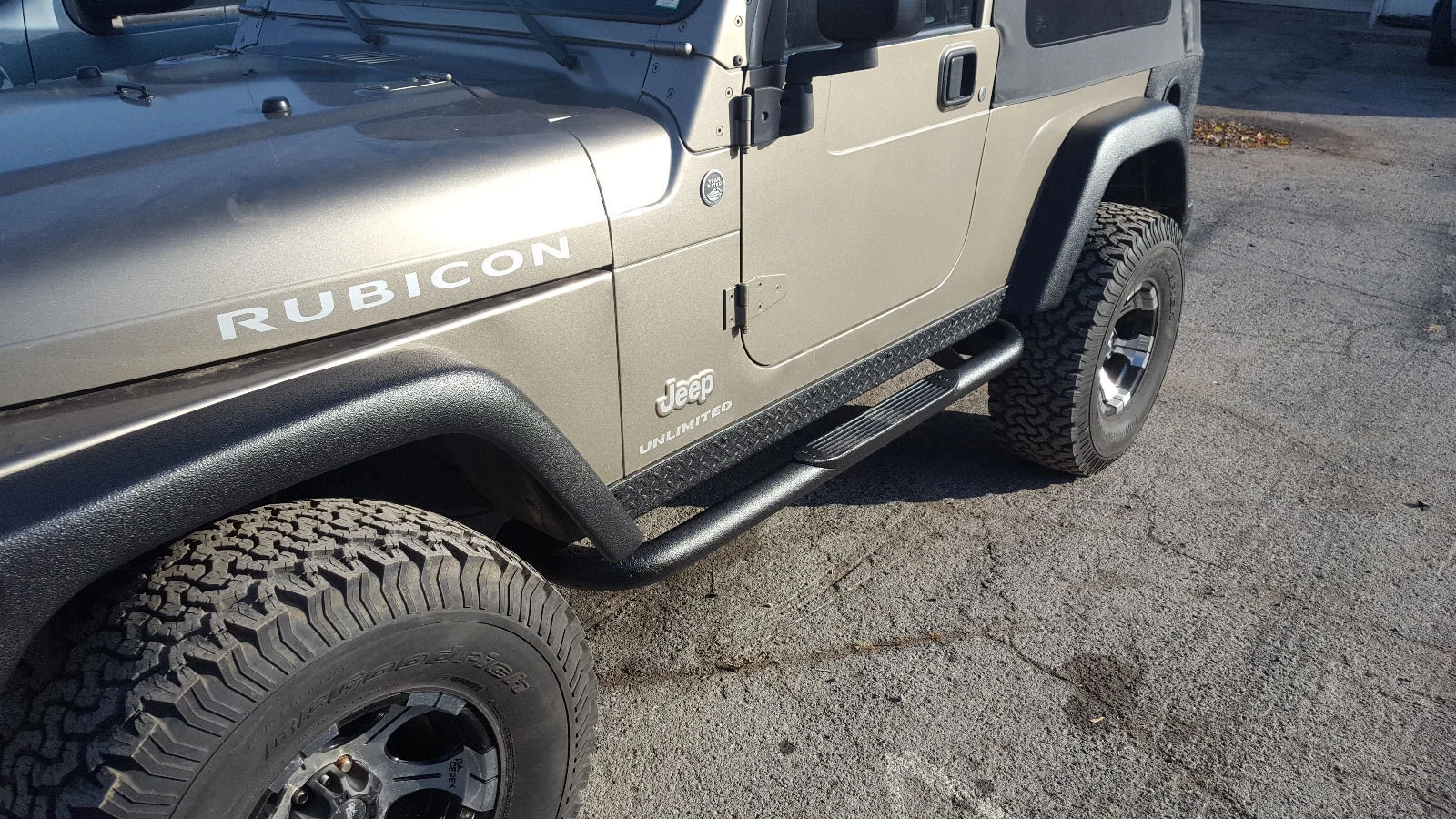

I wonder if there's a difference between the standard flares and the Rubicon/Sahara flares.
The wider ones are all painted, from the factory.

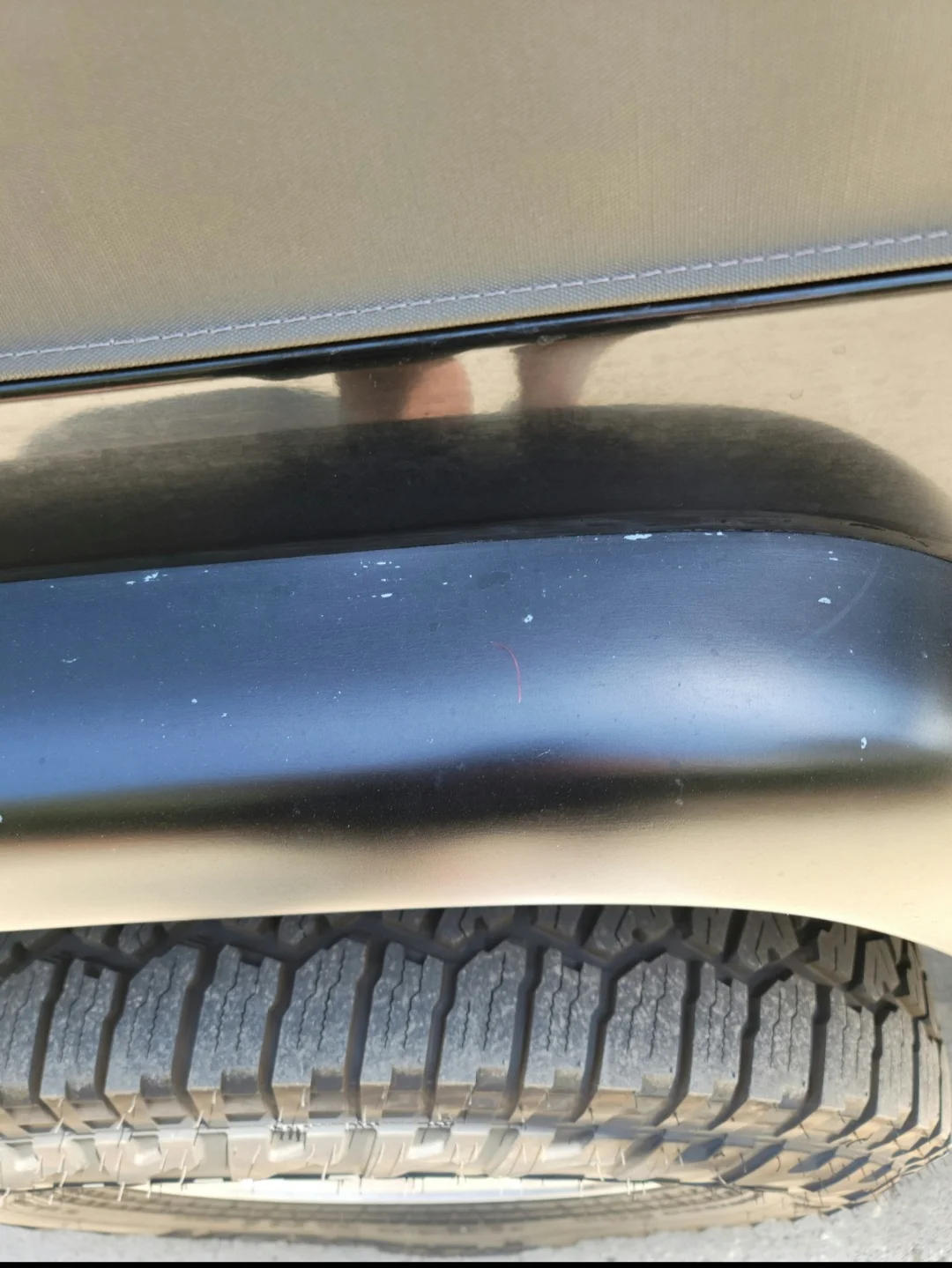

I have heard people say all the wider flares (Rubi and Sahara) are painted but I'm not convinced my stock Rubicon flares were painted black. It looks like black plastic that is sun faded. The sides of my Jeep have substantial scratches from branches off road and my flares do not show any of that.

@Viking Jeeper paint fades, you should see my hood. Some Jeeps had color coded flares too. I've seen heavily damaged black Rubicon flares and the outer surface was different, that doesn't mean it was paint, just some different treatment.

I also have a used set of painted Sahara flares to compare to and that is what finally convinced me my rubicon flares were not painted.

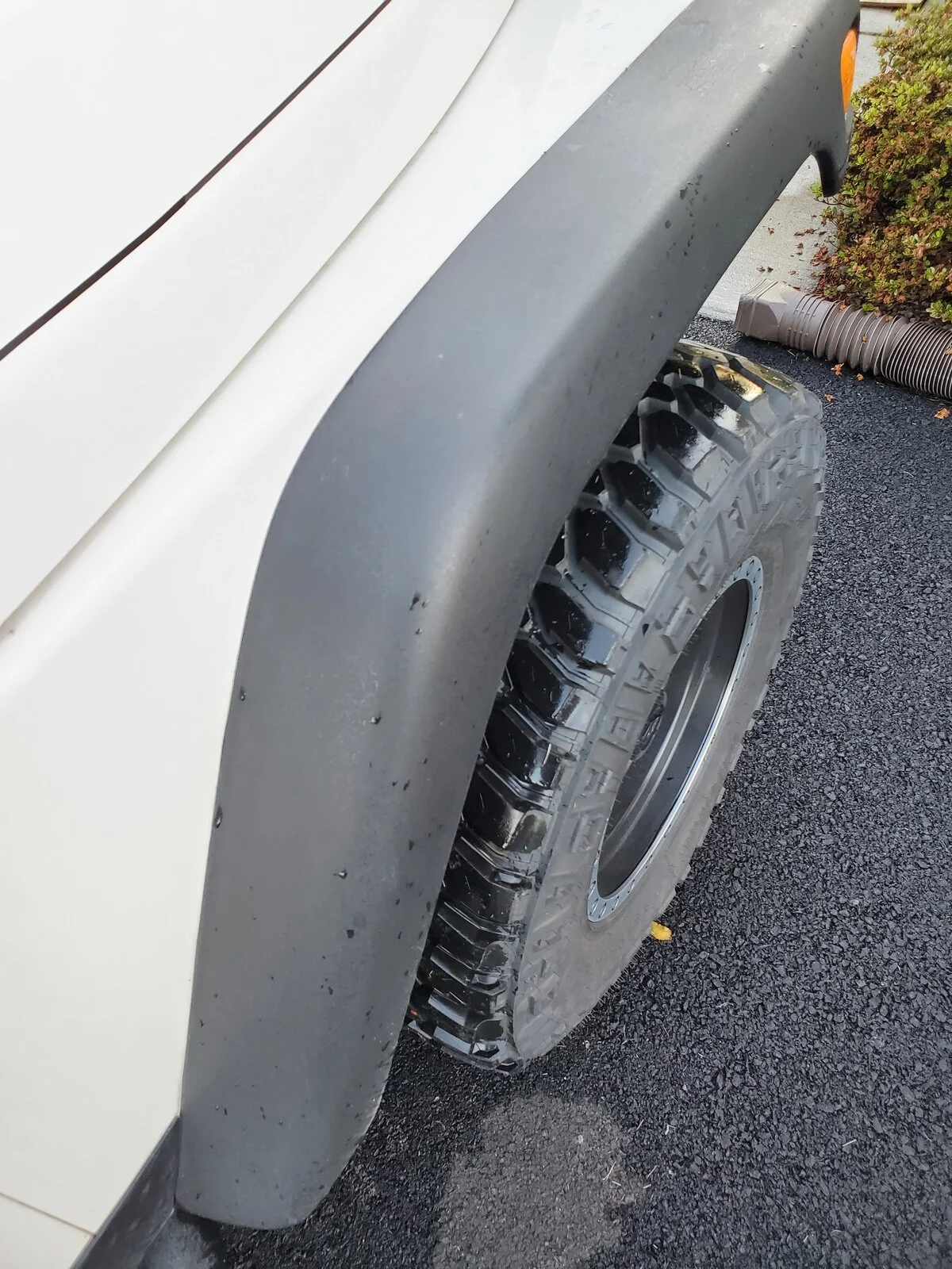

I did the Rust-Oleum bed liner in a spray can about 4 years ago on my Rubicon. It's still holding up great. I like the Rust-Oleum because it's a much finer texture than something like raptor liner.
From when I did it...
And today (like I literally just took the picture)
AFAIR, I scrubbed them with a green scotch Brite and dawn dish soap, then wiped them down with denatured alcohol (my go to for cleaning plastic). Next step was duplicolor adhesion promoter. Then the bed liner.
One thing to remember when painting old flares... If anyone used armor all or any other plastic restorer, you're going to have a tough time painting them. Doesn't matter how long is been since the product was applied. Those products almost universally contain silicone, which is how they shine up the plastic. Silicone is nearly impossible to remove chemically. You need to mechanically remove it... Like sand it off and expose "new" plastic. @Moab I'd wager that is why you're having issues. At this point, you'd be better off buying new. Too bad they don't sell the Rubicon flares anymore...
