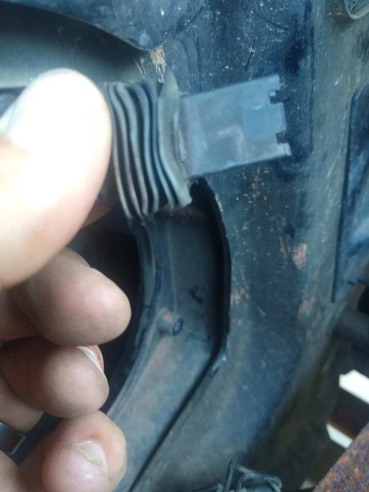

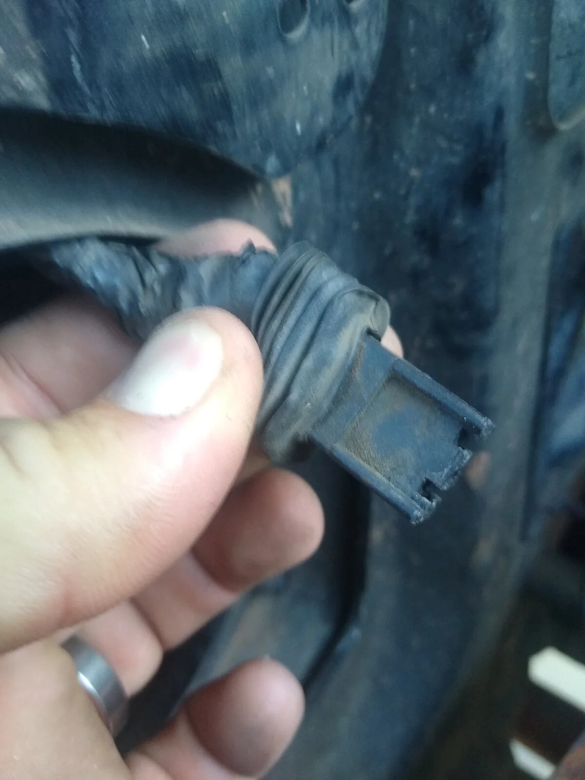

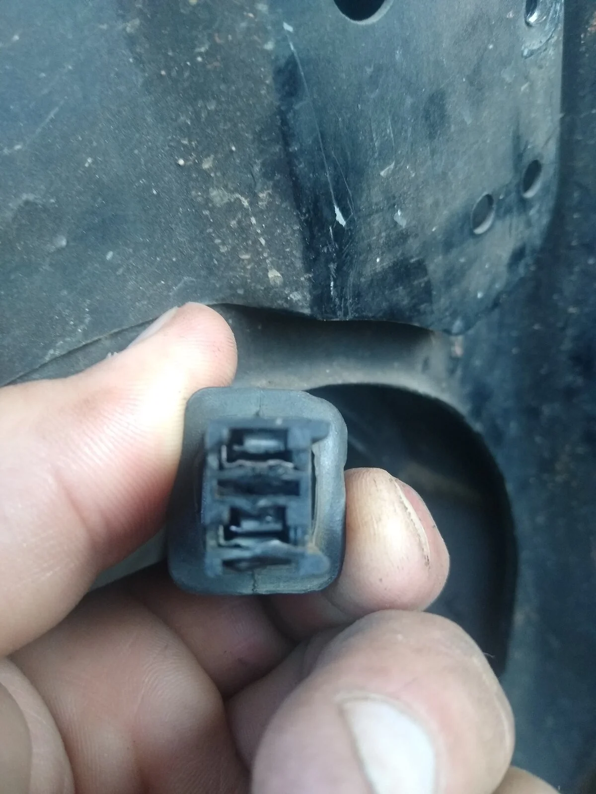

My blower will work if I push on the plug at the blower motor (behind the battery in the engine bay). So I pulled the plug and noticed it was some what melted. I'm ordering a new motor (since they're not really that expensive) and I want to change out the plug while I'm there. I can't find this plug to order or I'm not sure if this is also apart of the resistor. Any help where I can find this please share

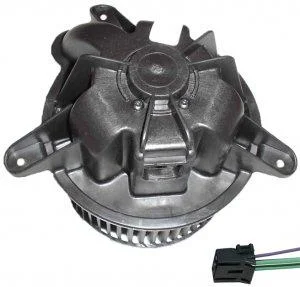

https://jeepair.com/products/tj-wrangler-blower-motor-wire-harness?variant=32066912321621
I bought this set up and it does not come with plug at the blower. The harness is for the head unit. Any ideas where to locate this plug at the blower itself? I am looking into junk yards as well

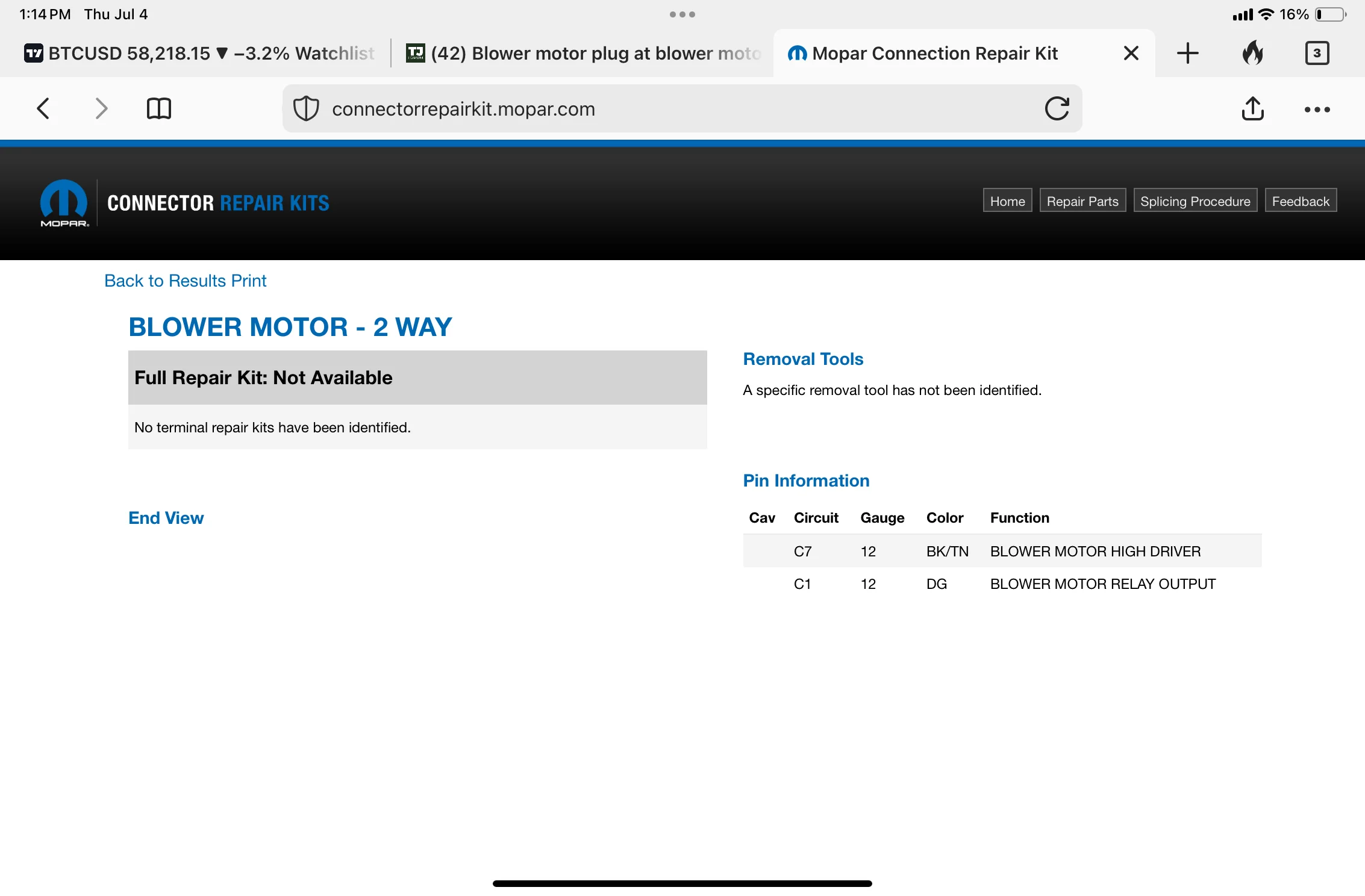

Dragging this back from the ethers. I am in need of this same connector. Does anyone have any leads on where to get it?
