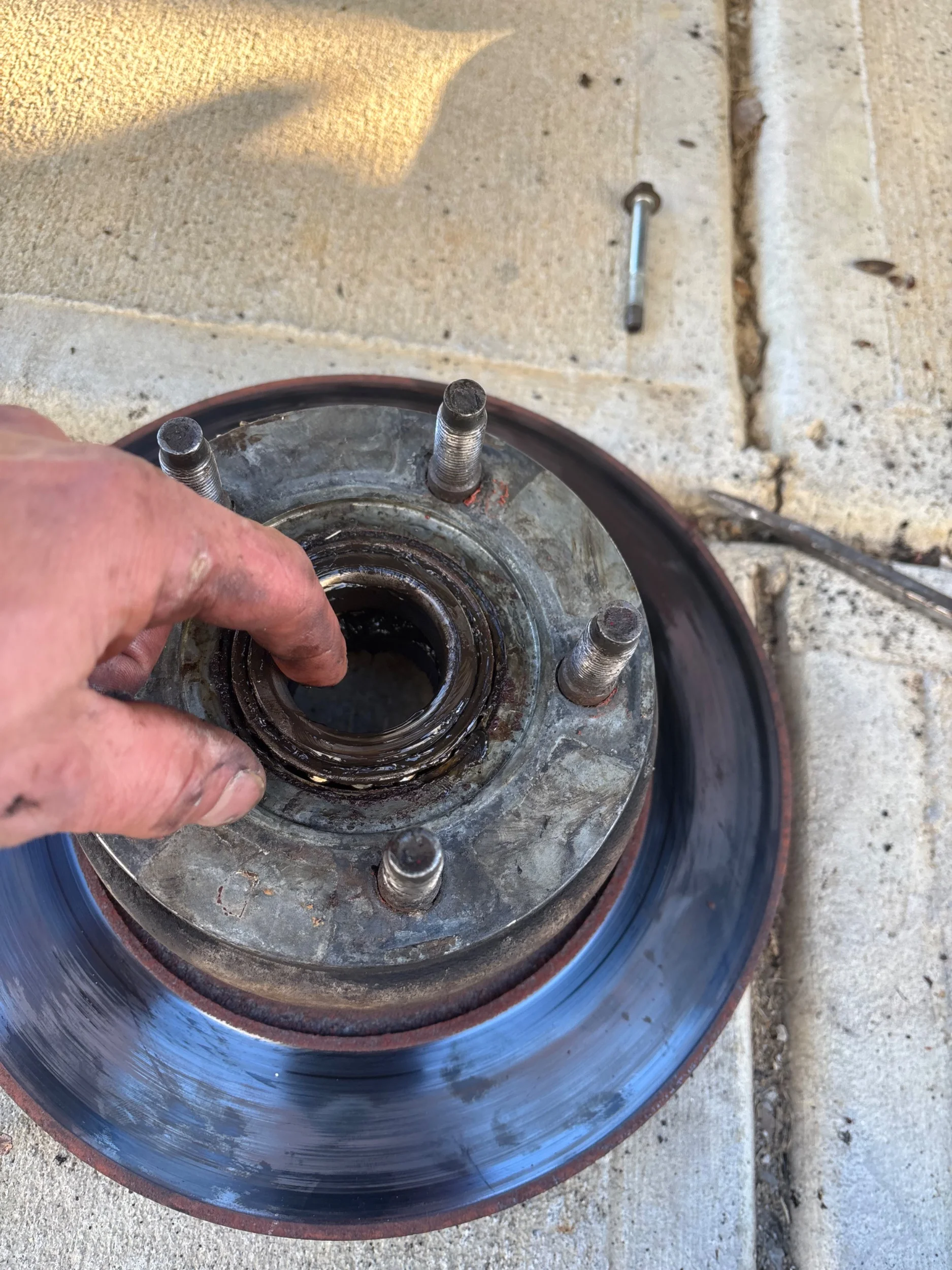

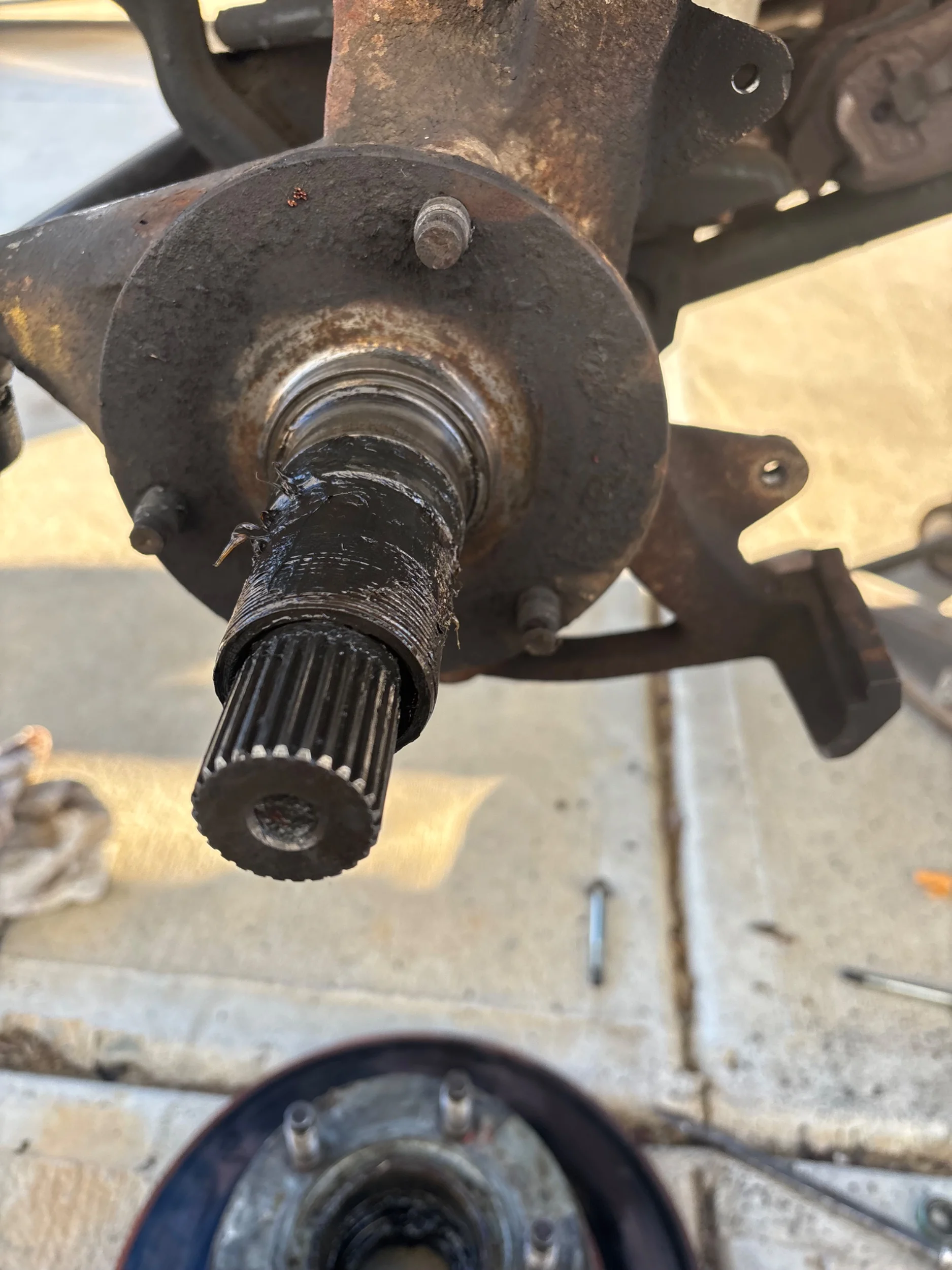

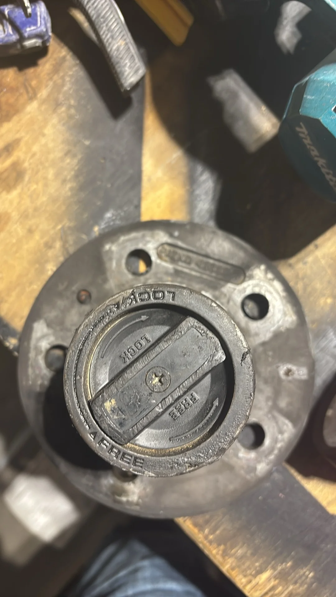

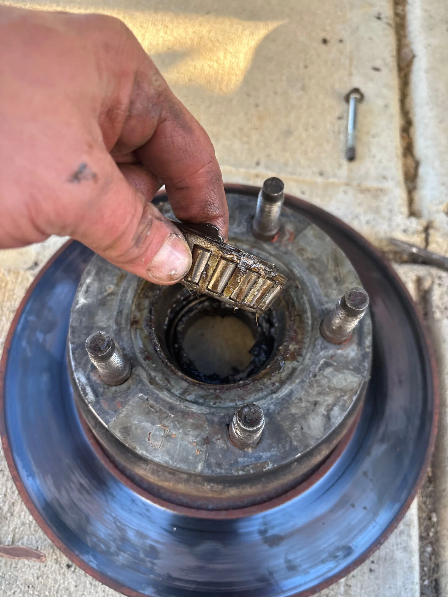

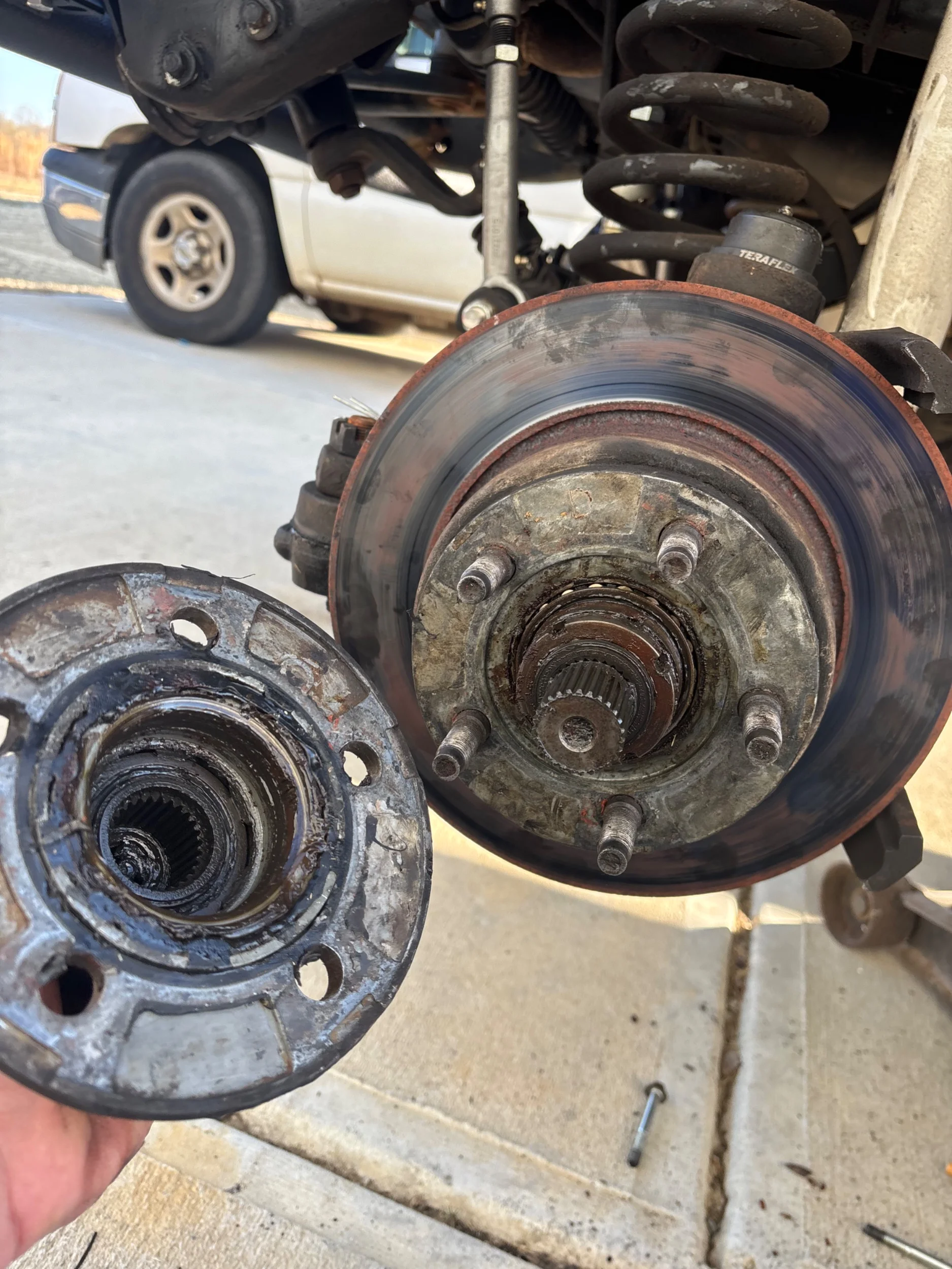

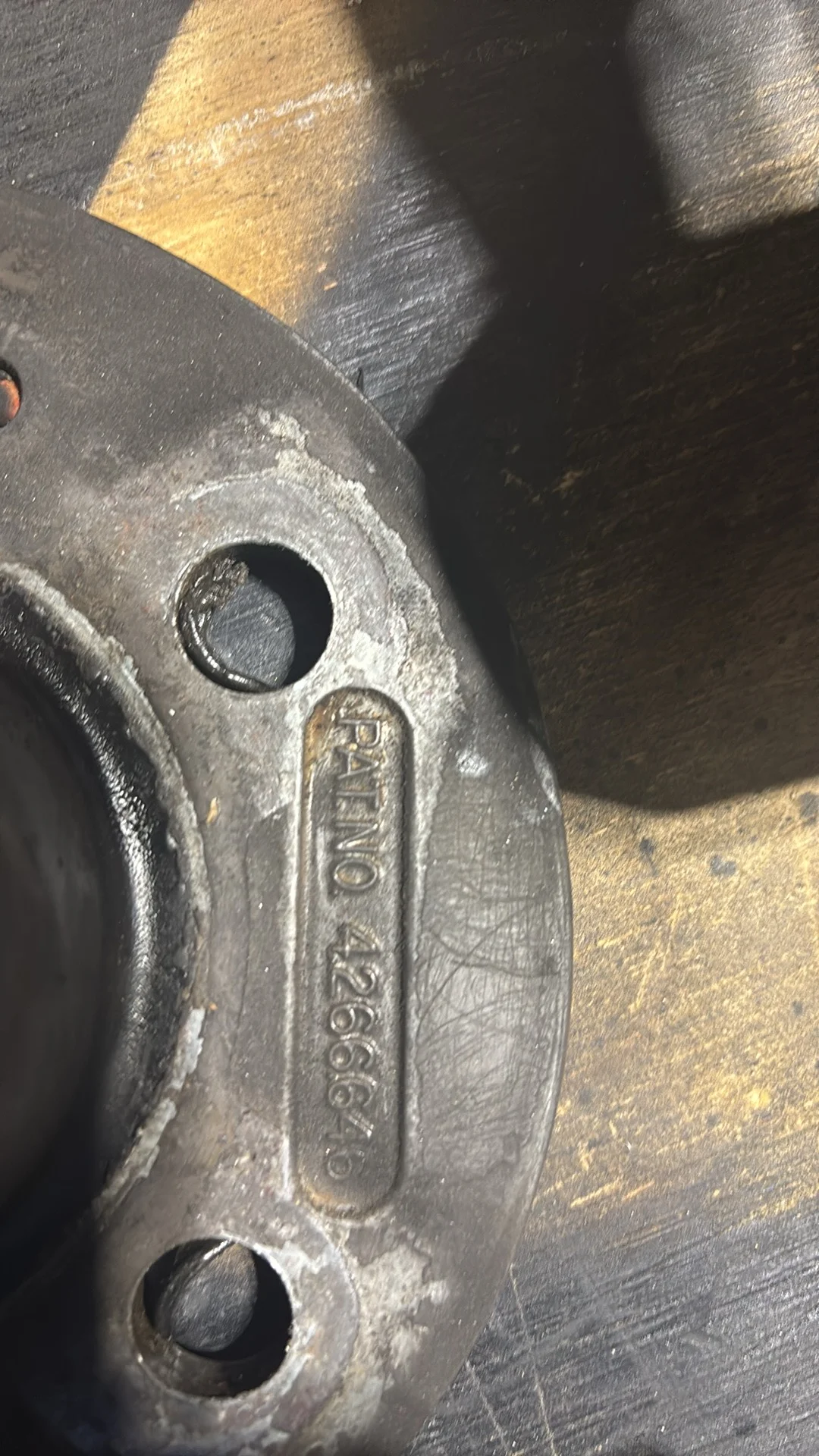

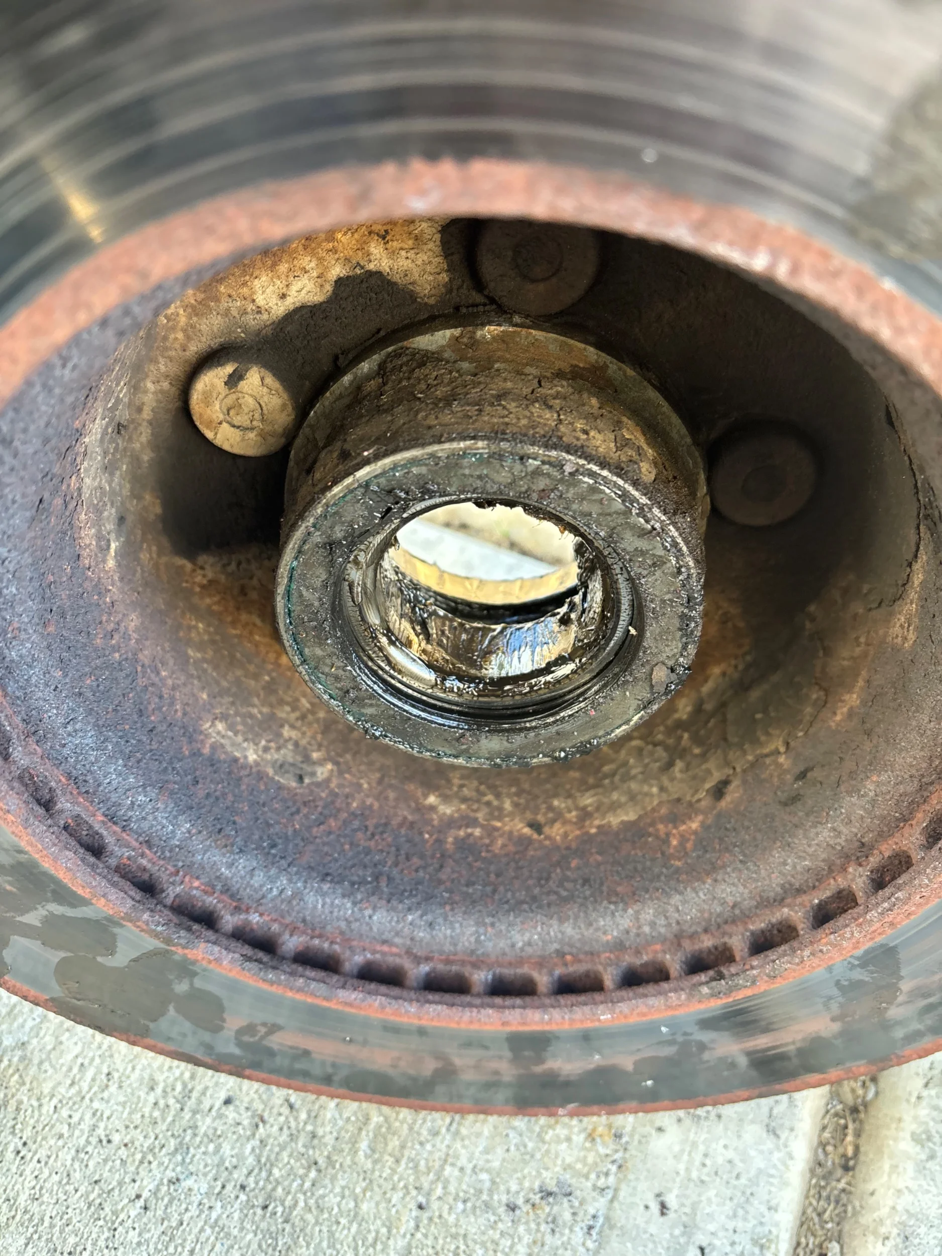

I just bought this jeep about 6 months ago. I had a seized caliper today decided it was time to just do the front rotors, pads, calipers . After taking the rotors off and digging a little I’m looking at ford possibly ranger or explorer rotors , bearings and hub lock. I am new to these machines and need help figuring out what they used also I can replaced them . I’m assuming they did some kind of brake upgrade or axle swap, it honestly I’m brand new and am kinda lost . Any info I can get would be greatly appreciated
that is a locking hub kit @mrblaine should be able to identify it.
He got me in a direct message so I'm working that out there. But it is or appears to be the Warn version of the Yukon WU-07 and should be using a stock early TJ full cast rotor. Centric number would be 120.67022 and then modify it by opening up the center bore to fit the bearing snout.
