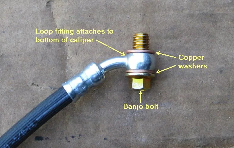

See pic
I appreciate the picture, but I believe that only applies to the front lines. The rear soft line is a bit different, and I can't see why it came packaged with new washers. As far as I can tell it should just connect via flare nut. Leftover parts make me uneasy, so I just want to be sure I am not missing something.
