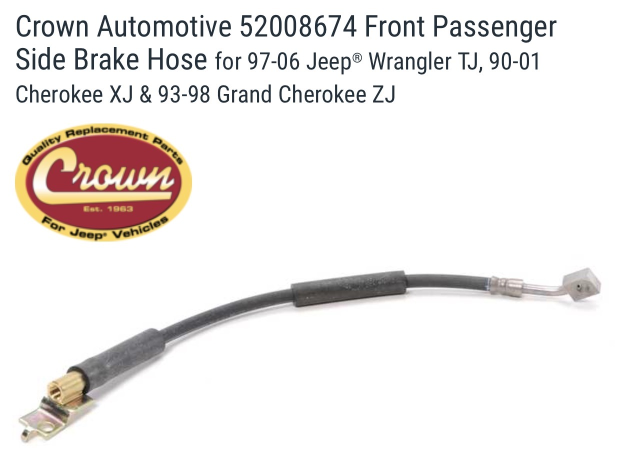

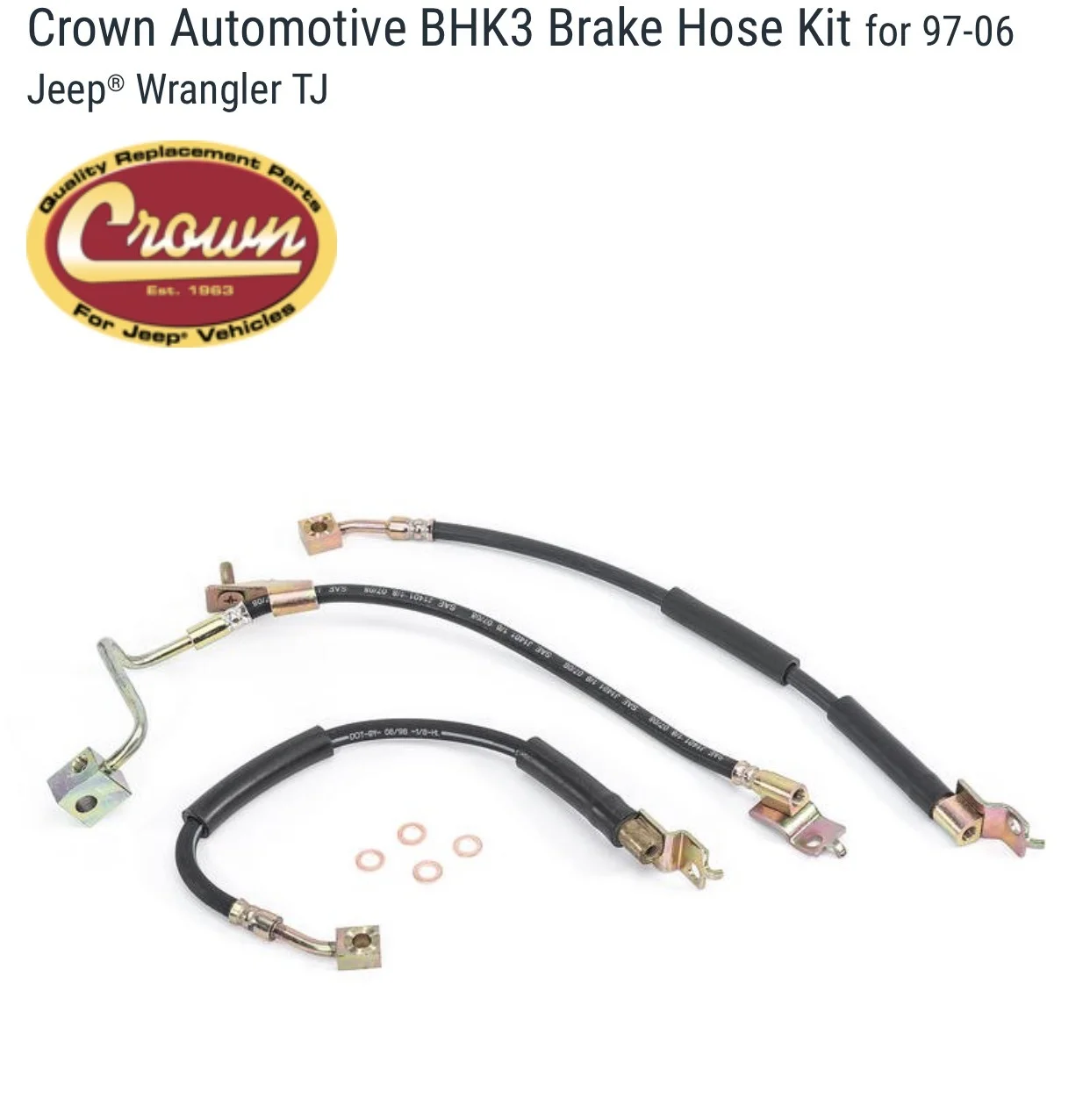

Crown Automotive offers OEM replacements that are pre-bent. Im sure they can be found cheaper on Amazon possibly
https://www.quadratec.com/p/crown-a...FsxRFfiXFs_Gtz69CaaB8AOAzI76jWI4aArVlEALw_wcB
For the passenger front specifically.
https://www.quadratec.com/products/56211_21.htm
Thanks for the replies, but I am really referring to the "hard" brake lines from the master cylinder down to the flexible lines. I will be replacing the flexible ones as well.
https://www.quadratec.com/products/22705_100_07.htm
