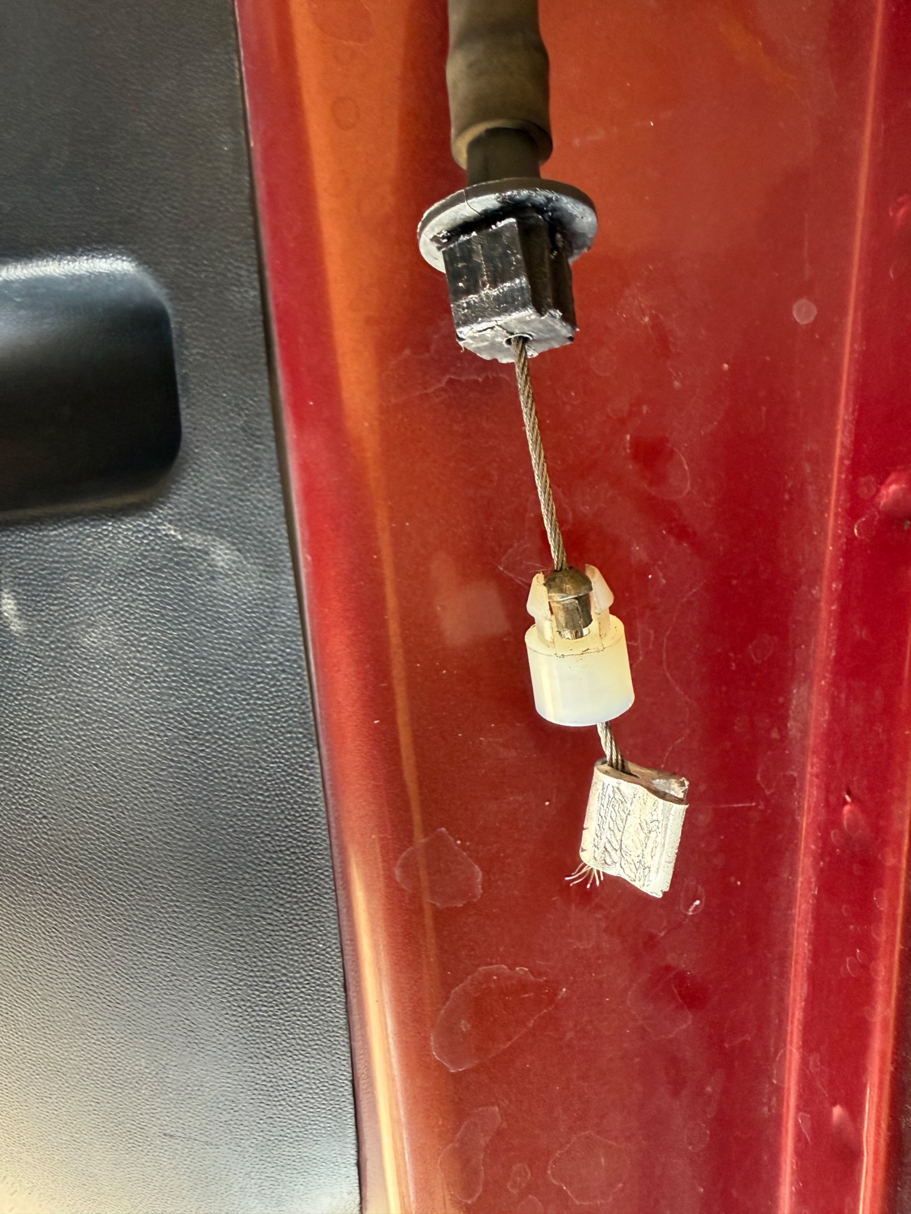

So to the other half of this equation: the gas pedal. Sure enough…. Someone had apparently broken the throttle cable at the pedal end and replaced either the entire cable or just the inner core. And managed to make the repair leaving the cable much too short. So my throttle is fully open with the pedal surface resting about 3.5” from the floor. Gee whiz! No wonder I’m hitting the pedal. Now off to find a new cable or replace the inner core on this one.

New (old used, but OEM) throttle cable showed up today. Three minute job to swap it. To no surprise my foot no longer hits the gas pedal while depressing the brake pedal. The gas pedal now sits a few inches lower than it did previously. Here’s The Amazing Bubba’s previous cable repair.
