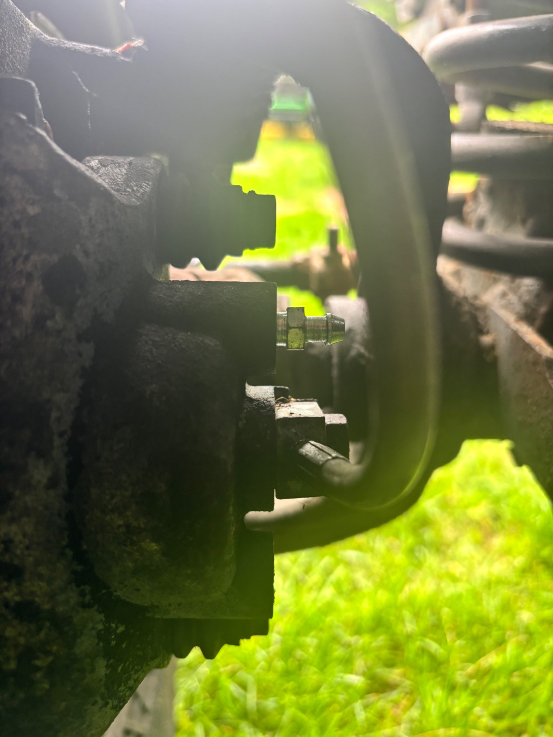

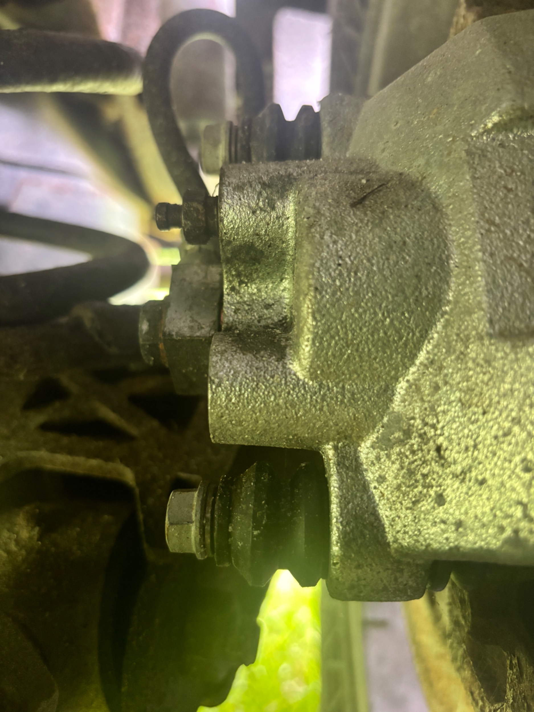

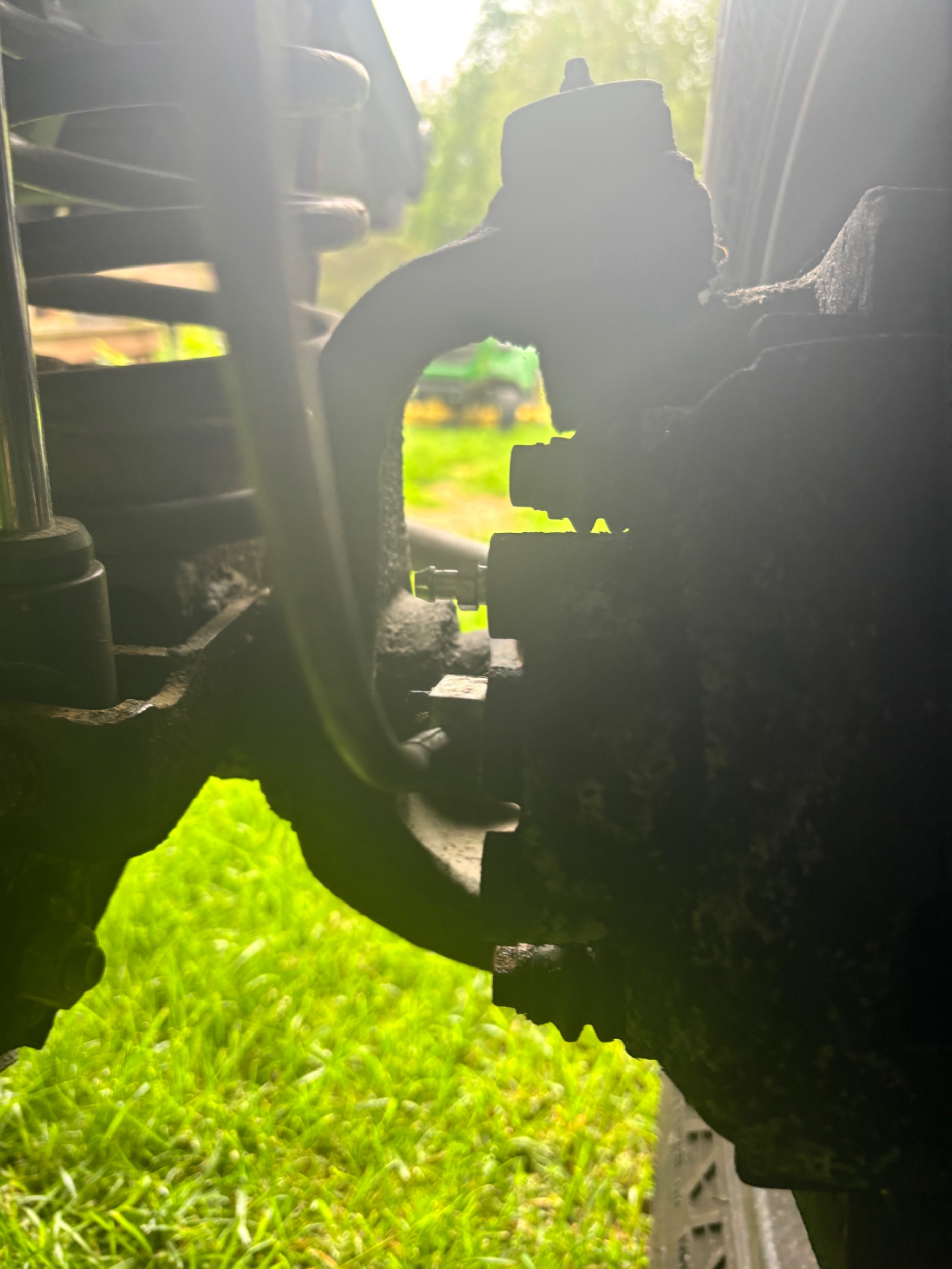

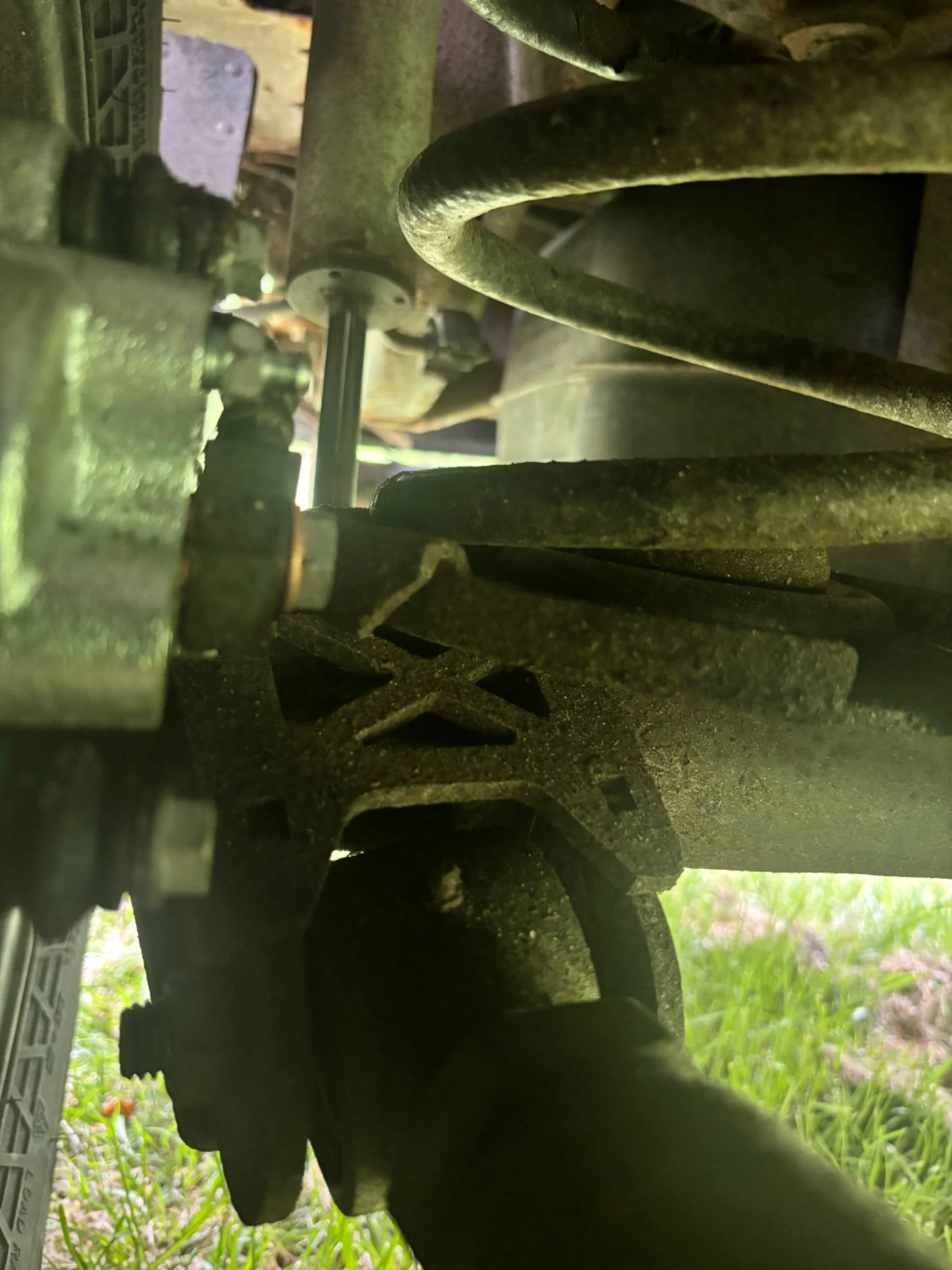

I was able to lock up the front tires again for a solid 15 feet after doing the pumping. I’ve included photos of my bleeders please tell me I’ve not been wasting my time.

Bleeders are correct, so that points to the booster push rod. If the push rod is too long, it won't let the pistons come back far enough to take in fluid to push out to the brake cylinders.
