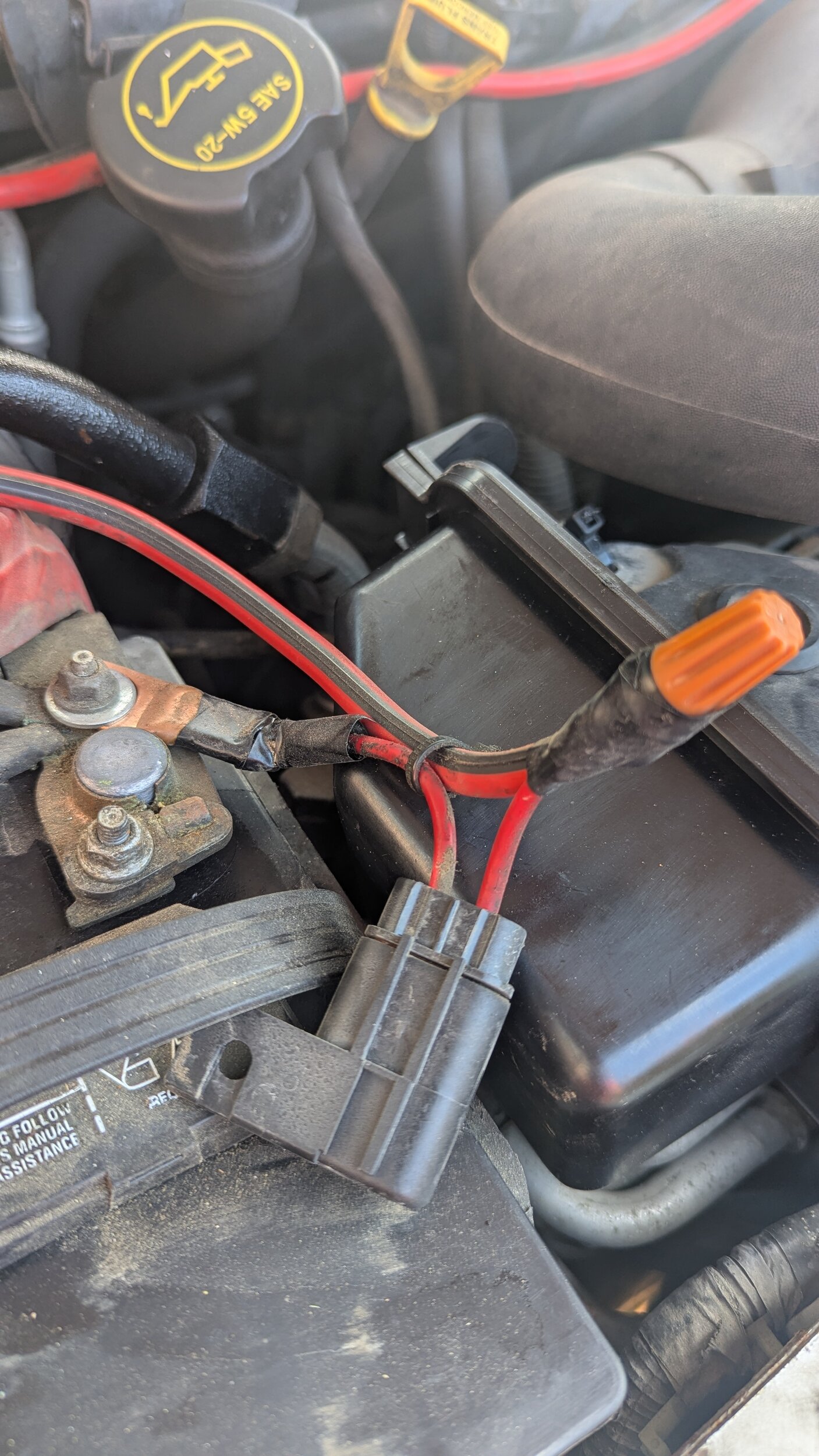

Yes, I knew it had a brake problem when I bought it. The fact that the van is 20 years old is a problem that is relatively easy to deal with, the big problem with this purchase is that the previous owner did a lot of modifications himself and now I am dealing with all his stuff as well. See below picture for example of his type of modification.
