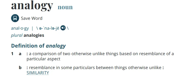

His point was that the mechanicals of the TJ are primitive at best. He fully understands how tractors, TJ's, Beemers, and many other vehicles are set up and his tractor analogy was merely meant to construe the lack of any sophistication present in the TJ or any of its mechanical bits. I fully agree with him especially when it comes to the brakes. Seriously Jeep? You used the same caliper that has been in use since 1990 and when you made the TJ Unlimited you changed nothing even though the rig is longer, heavier and has a higher towing capacity? You toss a 4-1 ratio t-case in the Rubis that will easily drive through the brakes offroad and it didn't occur to you to at least toss on a saddle mount caliper? If not tractor then most assuredly tractor mentality.

And I ask what is the particular resemblance that is more similar to a tractor than to any Italian car?
