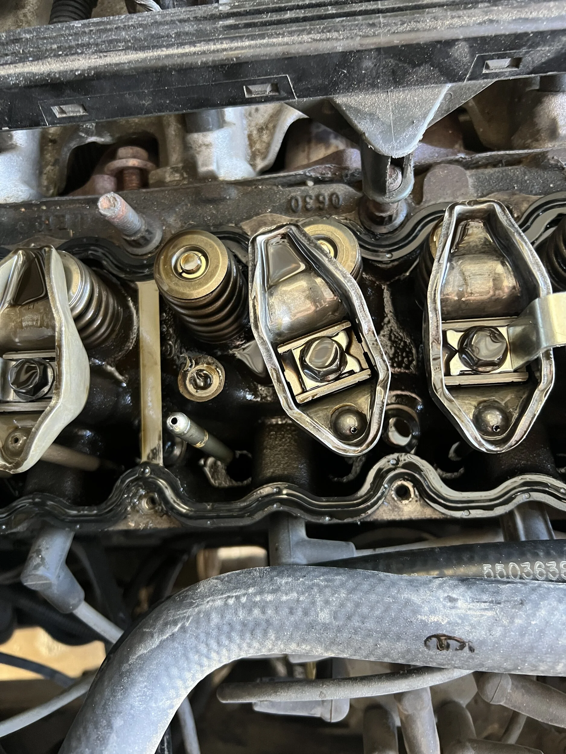

Thank you for your help. I've removed the broken bolt and rocker but the one next to it is situated at an odd angle. I don't know if this indicates anything or not. I get a bad feeling I'm headed for a rebuild..........
That doesn’t look good from what I can judge in that picture.
Remove the push rods from two other valves, look down in the holes and compare the appearance of the lifters to see if the lifter appears damaged. There is a chance lifter collapsed or there is a bent pushrod.
I suspect there may be a problem with either the pushrod, lifter(s) or cam lobe(s) for those valves.
I suspect there may be a problem with either the lifter(s), lobe(s) or both for those valves.
Will do. Also wondering if my camshaft is in bad shape. I'll get a visual on things tomorrow. Thanks for your help.
