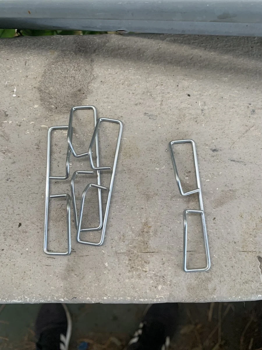

What are these clips for? There were none in the jeep
