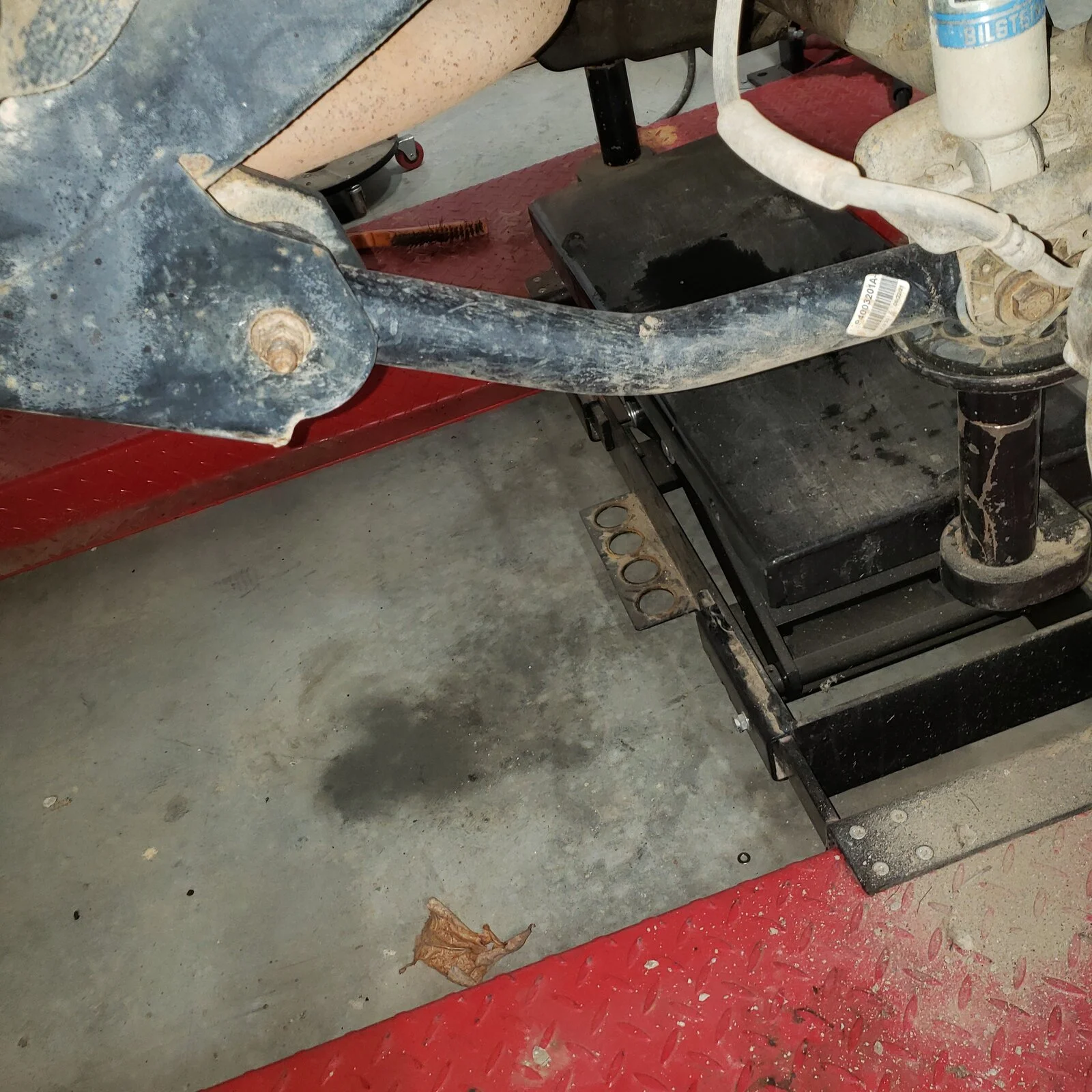

Can anyone identify this lift?
Edventure
Apr 14, 2022
6
Arkansas
Use the numbers on that sticker and type them into Google. That should bring something up.

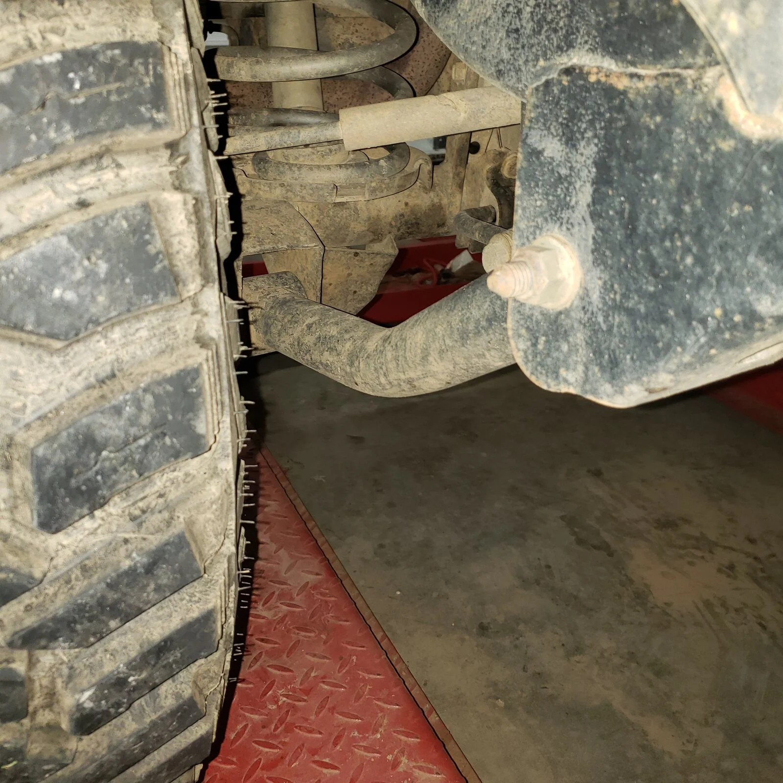

Whatever it is it's a cheap lift given that those are fixed length control arms (garbage IMHO). The shocks are Bilstein 5100s.
Reactions: Kid Mechanic
The rubber bushings may help, but you really need something like a Johnny Joint at one end (if possible) of those control arms. Those arms are a fixed pipe and welded solid at both ends. That means they do not twist like the factory arms. Therefore the brackets on the axle and frame take a lot of force under articulation. Basically it is trying to rip the brackets off because the arms don't twist.
