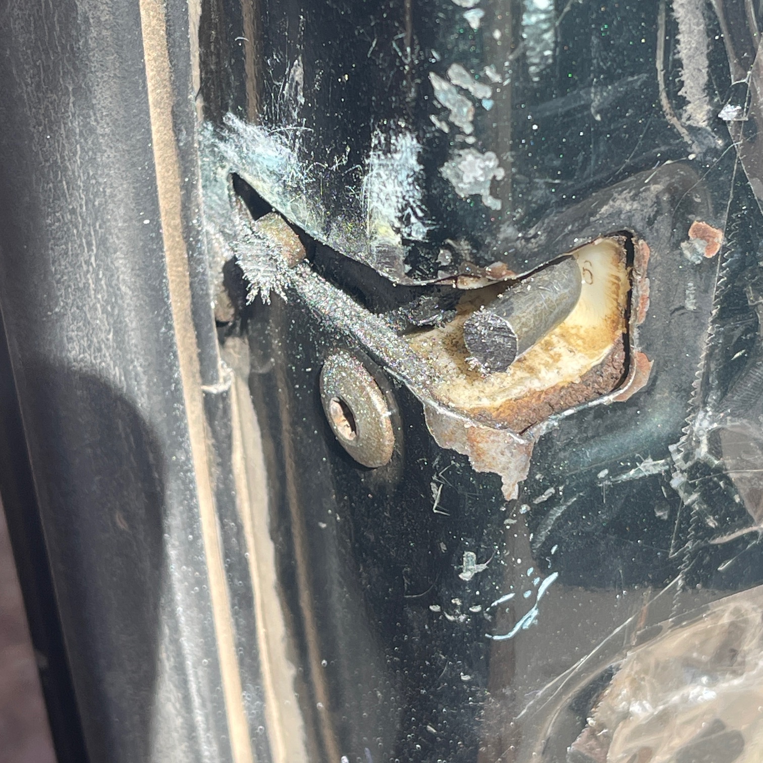

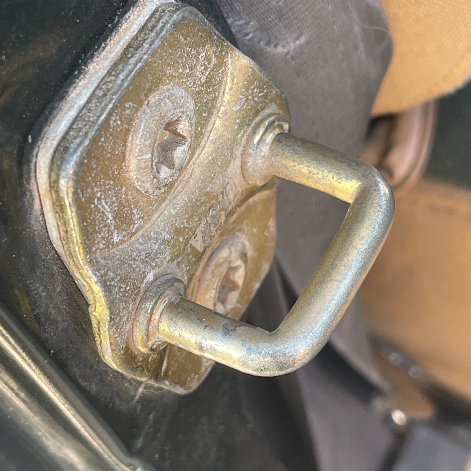

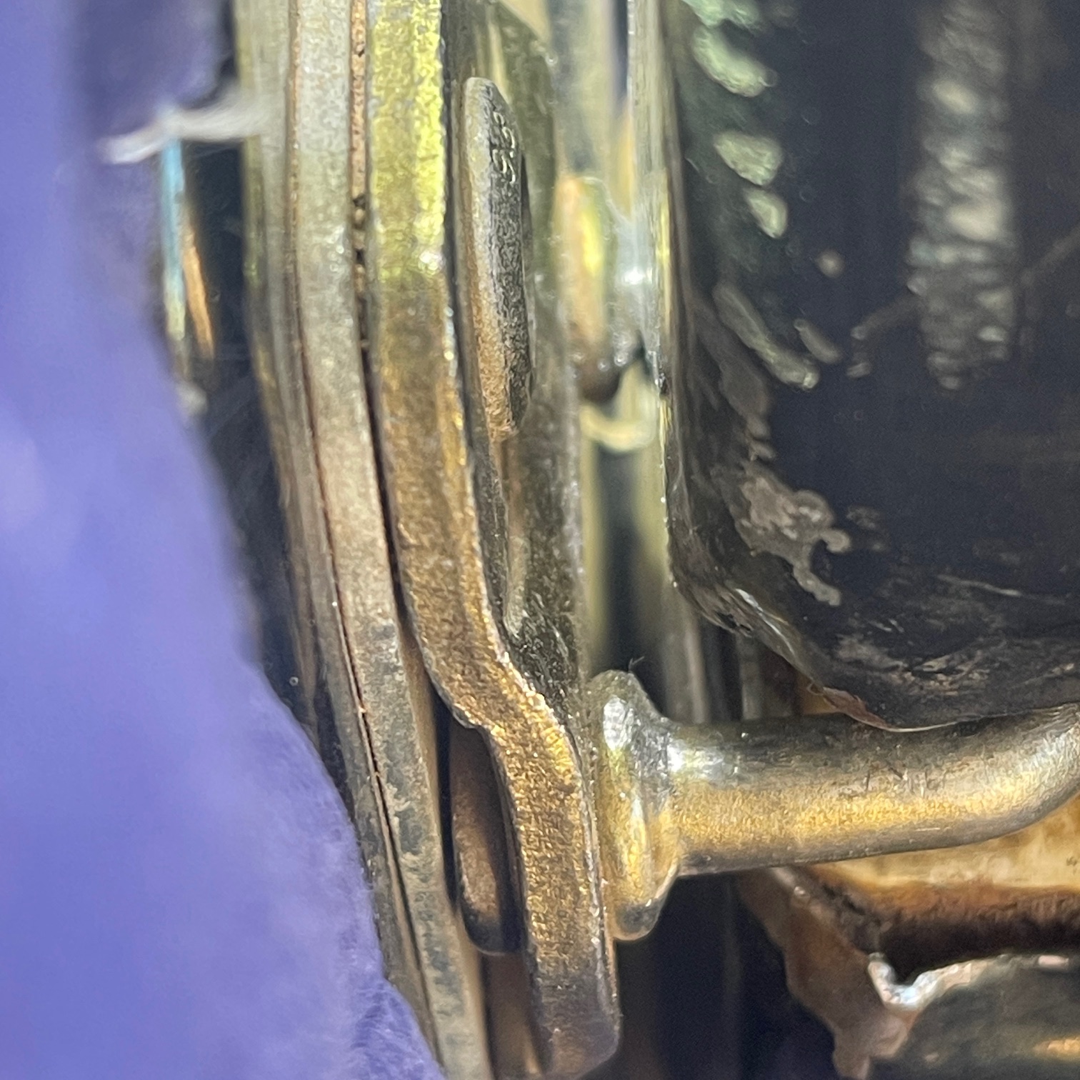

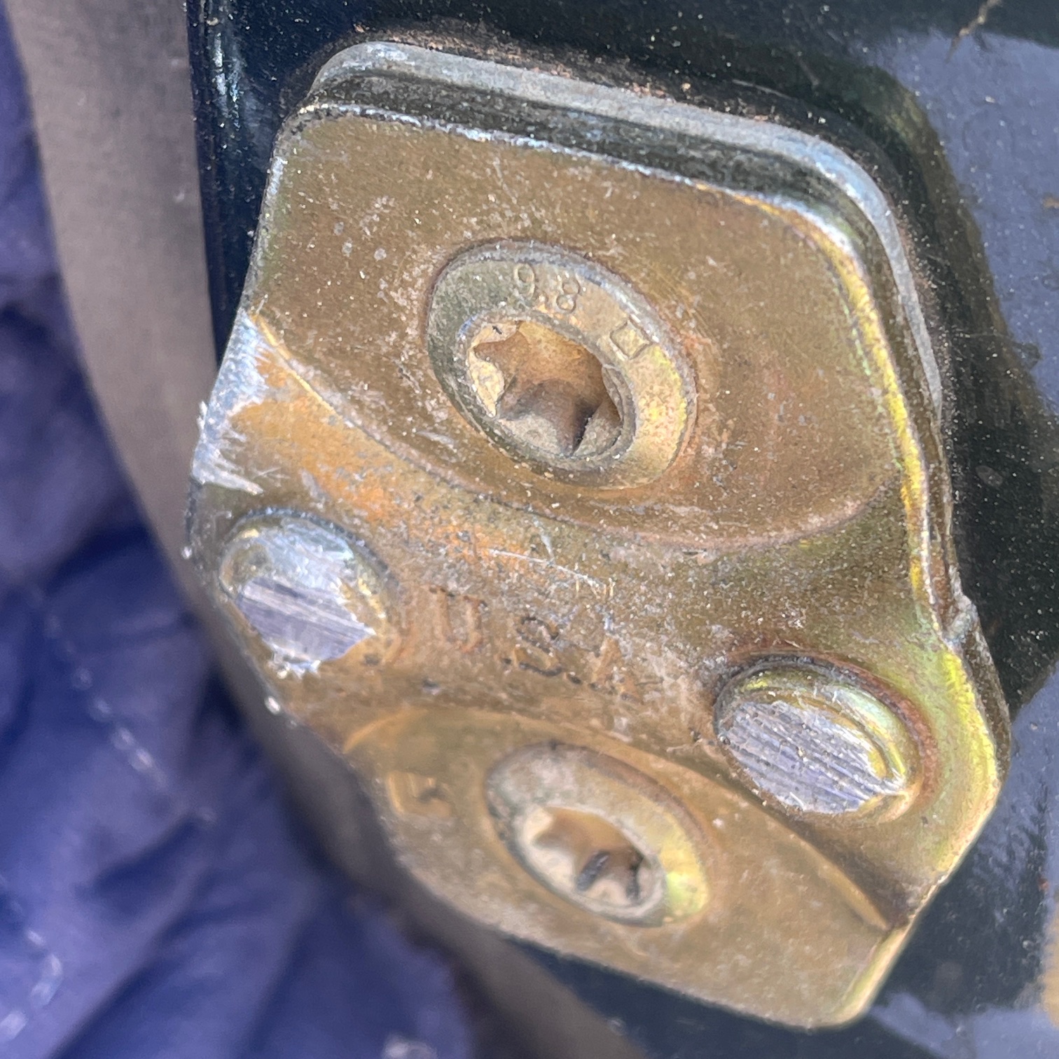

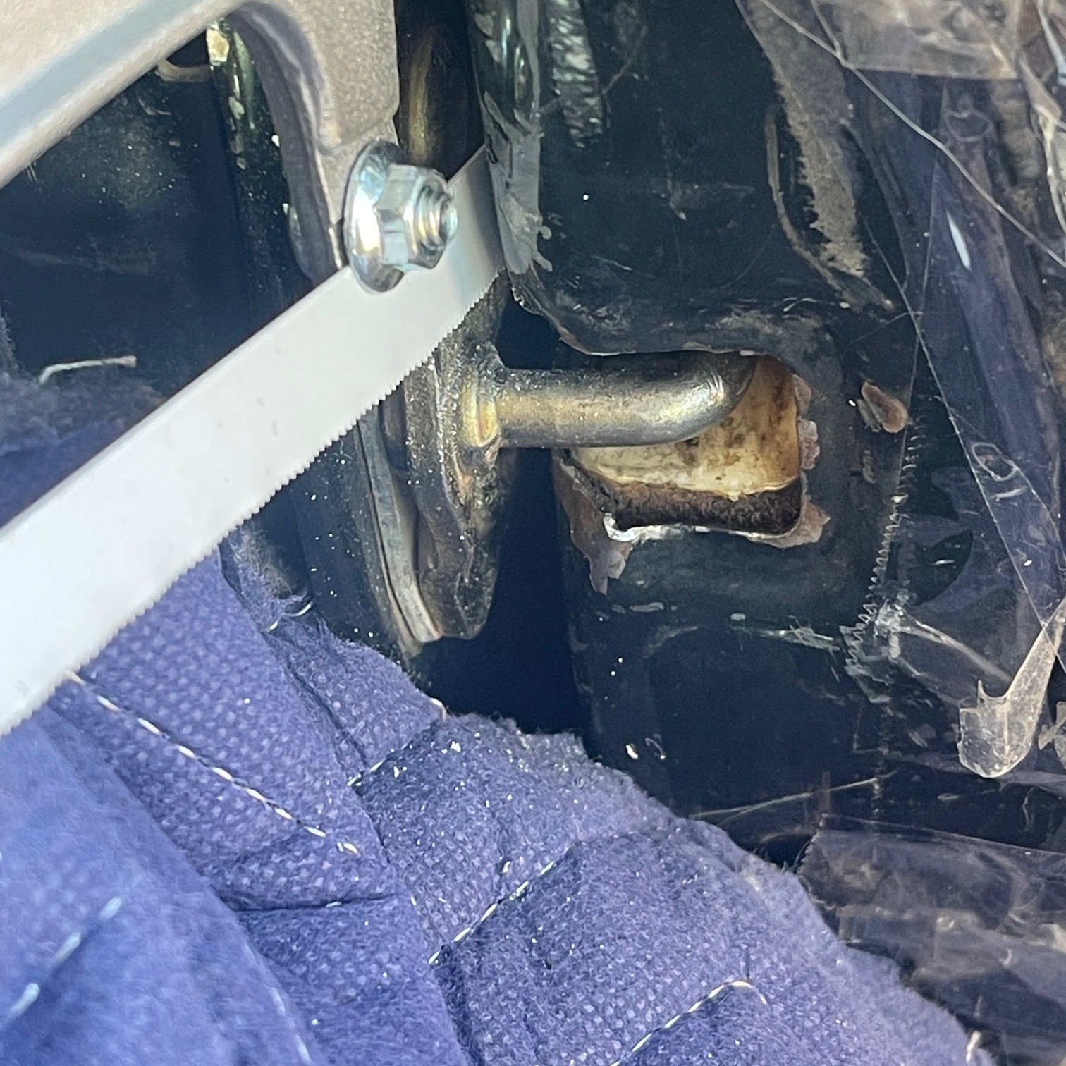

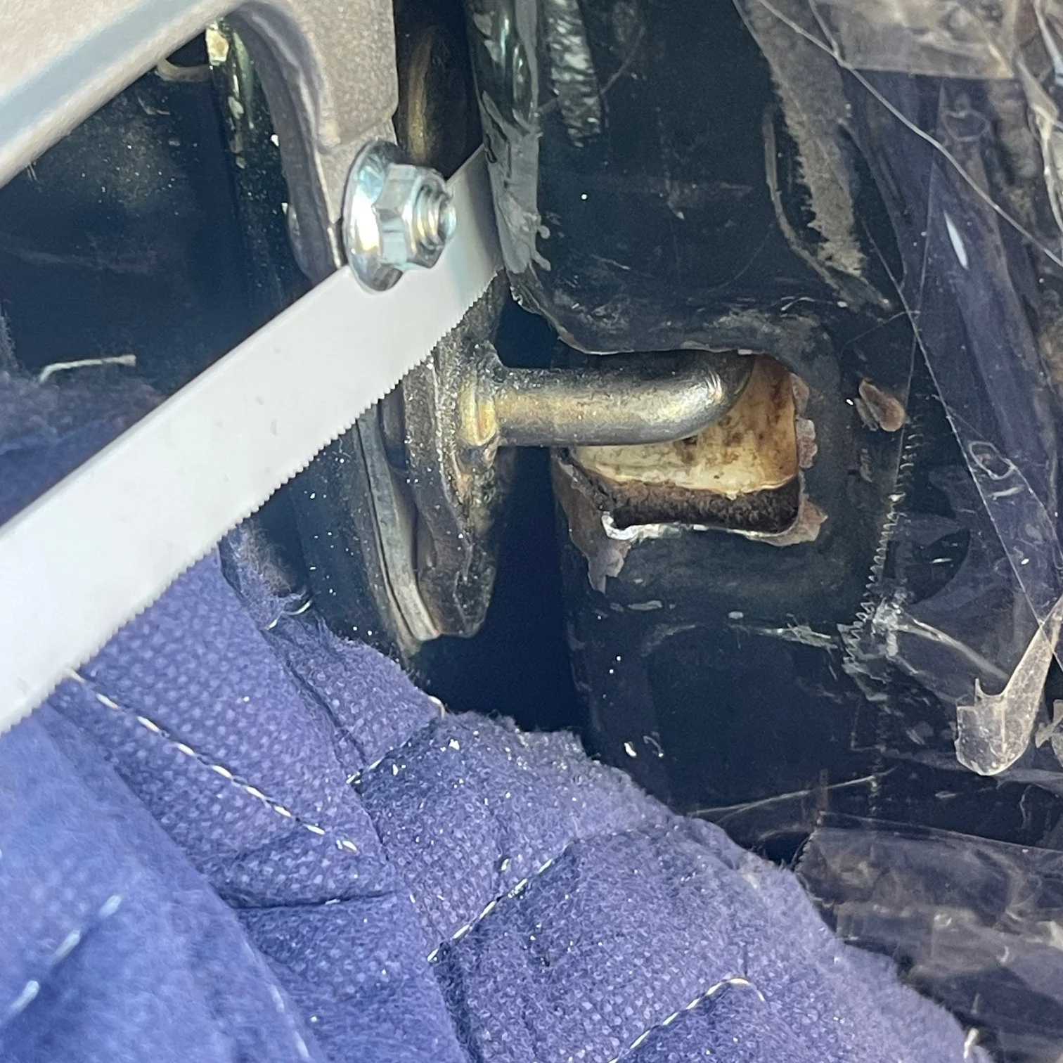

Well I decided to cut the striker loop post. He's some info for the next guy with a jammed door locking mechanism.

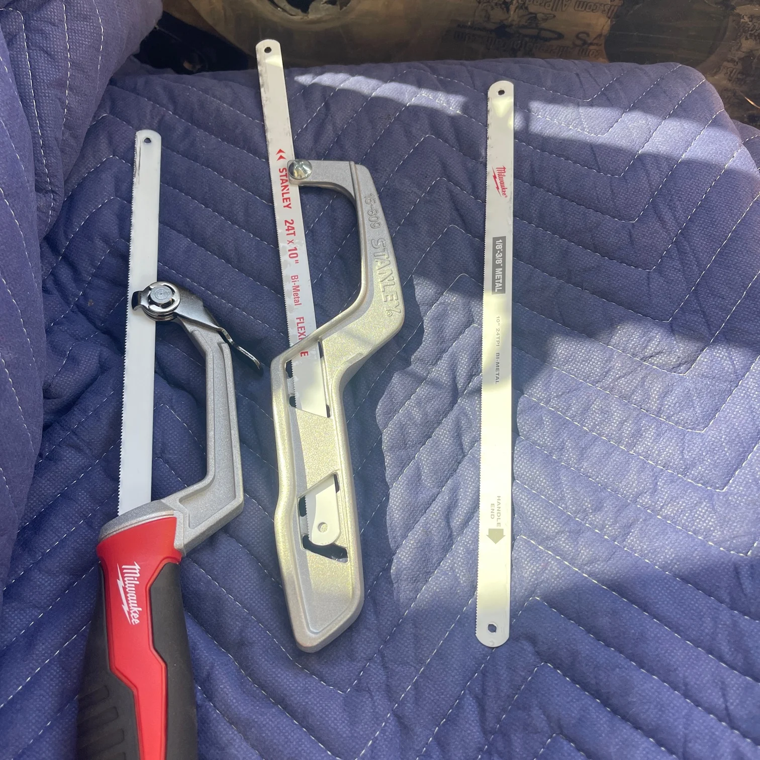

You are going to have to use a hacksaw blade on the outboard striker loop post. Expect on spending about 30 mins sawing to get thru it as there is very little access and approx 1/2 inch of allowable saw blade motion. The Inboard loop is simple and quick with plenty of access. Once both are cut the door will swing open allowing access so you can remove and replace the door lock assembly.
Posts always go better with a few pictures:
Not much room
This kind of blade holder work well
Striker loop still stuck in door latch mechanism
Striker loop
