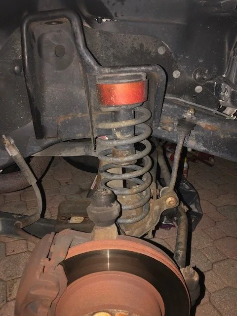

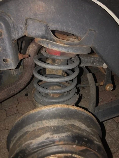

Got the Jeep in December and don’t know about this lift. I think it may be a cheap 2” Skyjacker puck lift? Can somebody help me identify what this is? Is it a leveling kit? The reason for my concern is, I have new Rancho shocks to put on and ordered them for a 2-3 inch lift? Should I use them or send them back and get the non-lifted shocks? Thank you in advance.
Send back the rancho shocks, ditch the cheap puck lift spacers and get a proper 2" lift spring and shock kit such as old man emu. Your jeep will ride much better. Or if you are on a budget just get rid of the pucks and return it to stock height and get some stock replacement shocks. And your bump stop snubbers are missing.
Reactions: 99TeeJay
Thanks GnB, that is the plan, to get a proper 2 inch lift. Believe it or not, the Jeep rides great and I just pulled the Skyjacker Hydro shocks that were shot. And I have the bump stops ordered too.
That looks like a 1.75-2” budget boost. Nothing wrong with it. Measure your true lift, the coil spring + red spacer. Anything over stock height is your true lift. Front stock is 12”; rear stock is 8”.
Then choose your shock length. Rancho 5000X run long, so if your true lift is 1-2” get the shocks for 0”.
